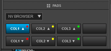

NV Browser mode
Press the SLICER mode button for more than 1 second to set the PADs to NV Browser mode. The special NV Browser page will be then selected and displayed on the Pads section of the VirtualDJ skin
This special page (available only when the Numark NV is connected) will provide the ability to sort Columns 1, 2 and 3 alphabetically in ascending on descending order, depending on the selected field of each Column.

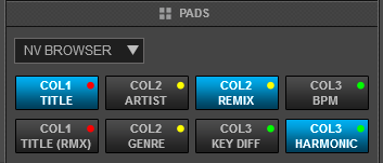

More NV Browser settings can be found in VirtualDJ Settings->OPTIONS tab ->CONTROLLER sub-category to adjust the displayed Browser columns on the LCD screens. The selections are saved across sessions and only apply to the Browser view of the NV Displays and not the Browser of VirtualDJ.
Use the BrowserColumn1 setting to display Title or Title (Remix) at the 1st column of the Files Browser view on the LCD screens of the NV
Use the BrowserColumn2 setting to display Artist, Remix or Genre for the 2nd Column of the Files Browser view
Use the BrowserColumn3 setting to display BPM, Harmonic and Key Difference for the 3rd Column of the Files Browser view
When the BrowserColors setting is set to Track Colors, the Tracks in NV Browser will get their defined color or white if not. If set to Played Status the Tracks will get the green color if already played and white if not.
