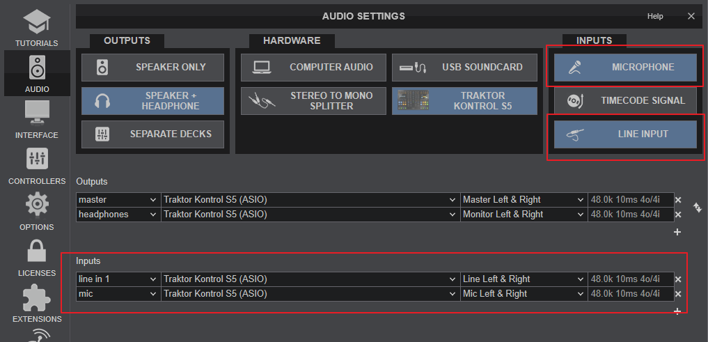

Kontrol S5 - Audio Setup with LineIn and Microphone Inputs added
Open VirtualDJ Audio Setup and click on the MICROPHONE and LINE INPUT buttons at the top-right of this window for VirtualDJ to add 2 extra lines for these inputs.
Make sure the linein 1 is assigned to the S5 audio interface and the Line Left & Right Channels as shown in the image above.
Make sure the mic is assigned to the S5 audio interface and the Mic Left & Right Channels as shown in the image above.

Note: By disabling the hardware Mic/Aux routing (AUX button turned off) and adding these inputs in VirtualDJ Audio setup, your mix will be recorded along with the signal of these inputs.

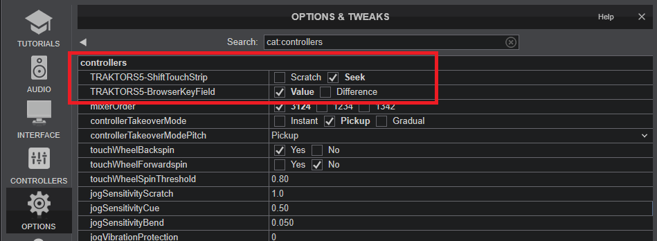

CONTROLLER SETTINGS
The KONTROLS5 offers 2 dedicated Settings when the device is connected. Open VirtualDJ Settings, go to OPTIONS and then select the CONTROLLER sub-category
[IMAGE2]
Kontrol S5 - Controller Settings
- ShiftTouchStrip : Change the behavior of the Touchstrip when SHIFT is held down. Choose between Seek (default) to seek/search through the Track or Scratch, to scratch the Deck
- BrowserKeyField : Select if the Key value (default) or the Key Difference will be displayed in Browser view of S5.
