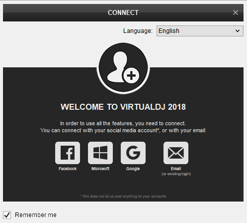

Once VirtualDJ is opened, a Connect Window will appear to enter your account credentials.
A Pro Infinity or a Pro Subscription License is required to fully use the Gemini PMX20. Without any of the above Licenses, the controller will operate for 10 minutes each time you restart VirtualDJ.

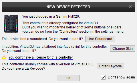

A detection window will appear when the unit is first connected with VirtualDJ, verifying proper connection.
Click on the "PMX20" button if your speakers are connected to the Master Output at the rear panel of the PMX20.
You can still make changes in the Audio setup from VirtualDJ Settings->AUDIO tab.
An additional Enter code button will be available, if your Account does not offer a Pro or Plus License or you have skipped the Login process.
Click on this button and enter the Keycode (serial) of your VirtualDJ LE.
On the PMX20, use the MIDI/USB buttons on each channel to enable the Midi operation.
Make your selections and press OK.
