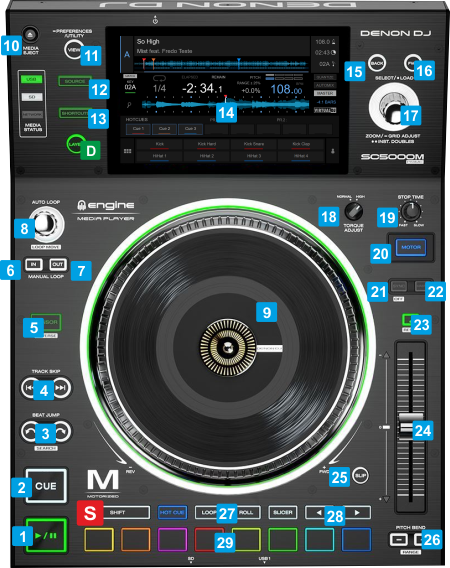

CONTROLS
KEY
ACTION
SHIFT (SECONDARY) ACTION
S SHIFT
Press this button down to access secondary actions as described in the SHIFT ACTION column
D LAYER
Select a deck for the unit to control
When a single device is connected or a 2 Decks skin is used , the SC5000M can be assigned to Left (A) or Right (B) Deck
When 2 devices are connected and a 4 Decks skin is used, the Left assigned device will toggle control for Left Decks (Deck A and C) and the Right-assigned device will toggle control for the Right Decks (B and D)
1 PLAY
Play-pause the track
Play-stutter track
2 CUE
When track is paused, sets a temporary Cue point and previews track while pressed if the Cue is set. Jump and stop to the Cue point when track is playing
Jumps at the beginning of the track
3 BEAT JUMP
Seamlessly move track forward/backwards by the same amount of beats as the selected loop size.
Fast seek through the track backwards/forward by 4 beats while pressed.
4 TRACK SKIP
Left Track Skip : Jump to the beginning of the track. Double-press the same button to load the previous track from the Browser List.
Right Track Skip : Loads the next track from the Browser List
5 CENSOR
Plays the track in reverse while pressed. When released, track will continue playing from the position it would have been if never used (CENSOR)
Toggle between Reverse and Normal playback
6 LOOP IN
Sets current position as the Start point (Loop In) of a manual loop. When in Loop, sets Jogwheel to Loop In Adjust mode and then use the Jogwheel to fine adjust the position of the Loop In point in time.
7 LOOP OUT
Sets current position as the End point (Loop Out) of a manual loop. When in Loop, sets Jogwheel to Loop Out Adjust mode and then use the Jogwheel to fine adjust the position of the Loop Out point in time.
8 LOOP
Half/double the size of the Loop in beats. Push to enable an auto-loop of the selected size in beats or push to exit the loop.
When in Loop, turn to move the loop backwards/forward by 1 beat
9 JOG
Motor wheel to scratch (if Motor mode is selected) or pitch bend. Loop In and Loop Out point adjustment (see Loop In/Out controls above)
The colored ring around the motor wheel will get the color of the assigned deck.
10 EJECT
Unload Track from Deck.
11 VIEW
Toggles between Normal Deck and Browser+Mini Deck views on the SC5000M screen.
Hold down for more than 1 second to open the SETTINGS view on the SC5000M screen.
12 SOURCE
Offers a confirmation panel on the SC5000M screen to switch to Standalone mode
13 SHORTCUTS
Show/Hide the Pads-Sampler-Custom buttons panel
14 DISPLAY
See Screen for further details
15 BACK
Sets Browser focus to Folders list. If focus is on Folders, open/close sub-folders
16 FWD
Cycles focus between available Browser Lists (folders, Songs, Sideview)
17 BROWSE
Scrolls through Files and Folders in the focused Browser list.
Push to get the Browser view. When in Browser view, pus to load the selected track to the Deck.
Double-fast-push to clone the Track (and its position and playback status) from the other Deck
Cycle through the available lists of Sideview (Automix, Sidelist, Karaoke, Sampler and Shortcuts).
Push to add the selected track of Songs List to the selected List of Sideview (Automix, Sidelist, Karaoke)
18 TORGUE ADJUST
Adjust the torgue of the motor wheel
19 STOP TIME
Adjust the time the track will need to completely stop. Set to Min for instant stop
20 MOTOR
Enable/disable Motor
21 SYNC
Match the corresponding Deck's tempo and phase with the opposite Deck's (or the Master Deck’s if using a 4 decks Skin) tempo and phase
22 MASTER
Manually set this deck as Master Deck.
23 KEYLOCK
Lock the track's key to its original value regardless the track's Tempo changes.
Smoothly reset Track's tempo to its original value
24 PITCH
Adjust the track's playback speed (tempo). When pitch fader is at the middle position (track is playing at its original speed), the white center LED will be lit.
When the green-arrow LEDs are lit, the pitch fader has to be moved to the direction the arrows indicate, in order to catch the pitch value of the deck. This is mostly happening when decks are swapped (via the LAYER button) and the pitch value of one deck is different than the other.
Note that this Hardware-takeover is not following the soft-takeover of VirtualDJ, meaning that if SHIFT is pressed, the arrows will not indicate the direction the pitch fader needs to be moved to in order to re-gain pitch control, but the ghost-fader on the GUI will be an aid
25 SLIP
Enable/disable Slip mode. When enabled, several actions like scratching, Hotcues, Loops etc will act temporary, and the track will resume playing from the position it would have been if the action was never triggered.
26 PITCH BEND
Hold down to temporary speed up/slow down the song while pressed. When released, the track playback will return to the speed designated by the Pitch Fader.
Select the previous/next available % range of the Pitch Fader
27 PAD MODES
Set Pads to a Pads page.
HOTCUE: Hotcues page (1st press), CueLoop page (2nd press)
LOOP : Loop page (1st press), Saved Loops page (2nd press)
ROLL : Loop Roll page (1st press), KeyCue page (2nd press)
SLICER : Slicer page (1st press), Sampler page (2nd press)
See further details in VirtualDJ Manual - Pads
28 PARAMETER
Adjust the 1st Parameter of the selected Pads page
Adjust the 2nd Parameter of the selected Pads page
29 PADS
