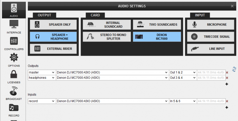

Recording & Broadcasting
The unit offers the ability to record the Master Output along with the Microphone and LINE Inputs directly from VirtualDJ record button (in the MASTER center panel). The dedicated Recording input channel is already pre-configured, so no further adjustments need to be done.

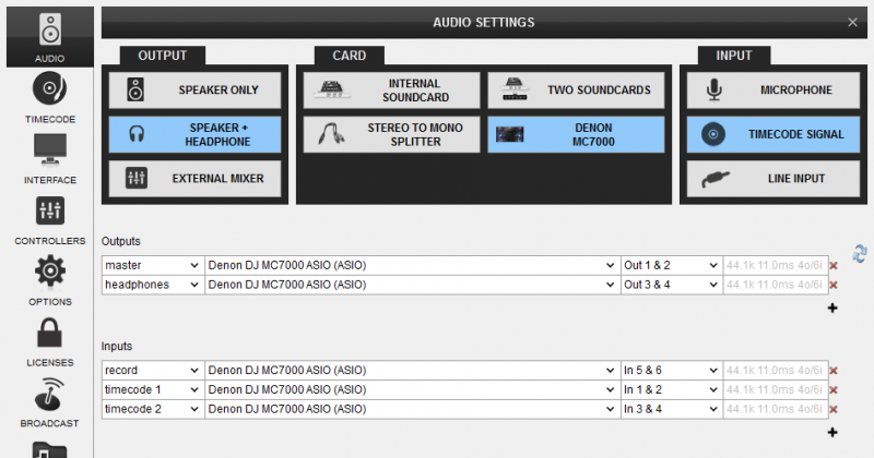

Timecodes (DVS)
The Denon DJ MC-7000 is offering DVS (Timecoded CDs and Vinyls) Support,
  • Connect your Timecode devices to LINE 3 and/or LINE 4
  • Place the USB/LINE switches from the top panel to USB position for Mixer Channels 3 and/or 4
  • Open VirtualDJ Settings ->AUDIO tab ans press the TIMECODE SIGNAL button from the INPUT tab
  • Click to APPLY
Audio configuration with Timecodes
Use the TIMECODE On/Off buttons that will be offered on the Decks (or in the SCRATCH panel for the 4 Decks default VirtualDJ GUI) to enable/disable Timecode control or use the Timecode signal to control a different Deck (e.g. swap Timecode control for Left decks when the 4 Decks GUI is selected)

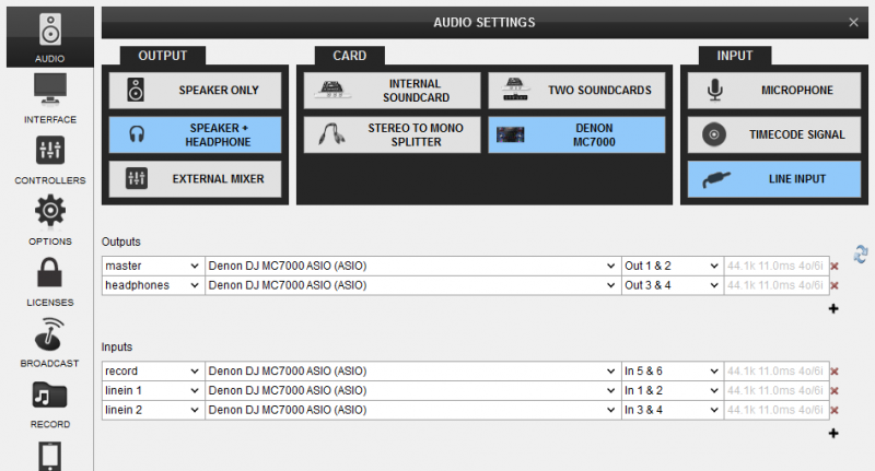

LINE INS
The same LINE Inputs 3 and 4 can be also used to send audio signal from an analogue media source connected at the rear panel to VirtualDJ for processing.
  • Connect your analogue media devices to LINE 3 and/or LINE 4
  • Open VirtualDJ Settings ->AUDIO tab and press the LINE INPUT button from the INPUT tab
  • Click to APPLY
Audio configuration with Line Ins
Use the LINE IN On/Off buttons that will be offered on the Decks (or in the SCRATCH panel for the 4 Decks default VirtualDJ GUI) to enable/disable Line In routing to a VirtualDJ deck.
This will provide the ability to synchronize BPM with other decks, use Effects etc.
