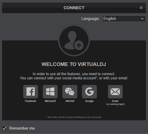

Once VirtualDJ is opened, a Login Window will appear. Login with your virtualdj.com account credentials.
A Pro Infinity or a Pro Subscription License is required to use the AlphaTheta CDJ-3000X with VirtualDJ. Without any of the above Licenses, the controller will operate for 10 minutes each time you restart VirtualDJ.

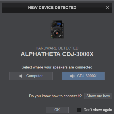

A detection window will appear next verifying the proper connection.
Click on the CDJ-3000X button in case the built-in sound cards of the CDJ-3000X are used and VirtualDJ will automatically apply the necessary Audio configuration. See Pioneer Club-setup Guide for further setup options.
Click OK.
The device is now ready to operate.

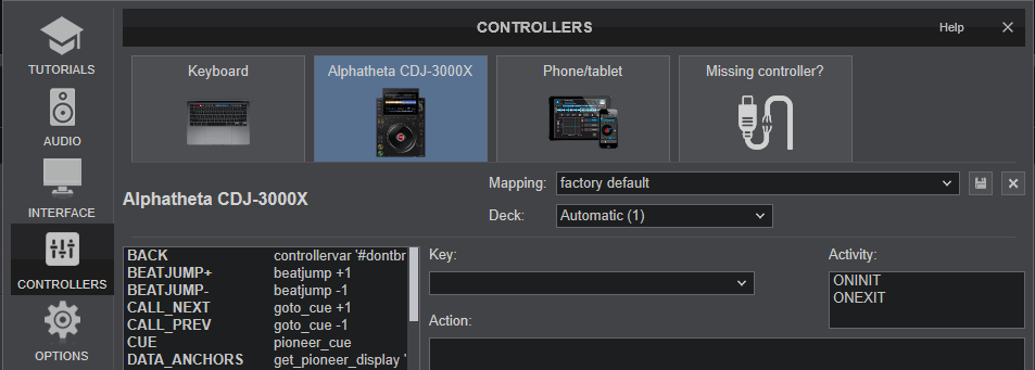

MIDI Operation
The device should be visible in the CONTROLLERS tab of Config and the “factory default” available/selected from the Mappings drop-down list.
The factory default Mapping offers the functions described in this Manual, however those can be adjusted to your needs via VDJ Script actions.
Note. Each CDJ-3000X unit (if more than 1 is connected) will be additionally displayed in this window, and any modifications in the mapping file will affect all units.
Find more details at http://www.virtualdj.com/wiki/VDJ8script.html

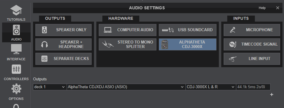

AUDIO Setup
The device has a pre-defined Audio setup and a special button in the AUDIO tab of Config to provide that. Alternative setups can be applied, depending your setup and the available units. See Advanced setup chapter
