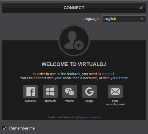

Once VirtualDJ is launched, a Connect window will appear to enter your virtualdj.com account credentials.
A Pro Infinity, a Plus Controller or a Pro Subscription License is required to fully use the Xone K3. Without any of the above Licenses, the controller will operate for 10 minutes each time you restart VirtualDJ.
https://www.virtualdj.com/buy/index.html

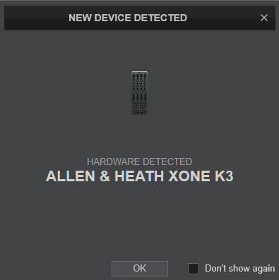

A detection window will appear when the unit is first connected with VirtualDJ, verifying proper connection.
Click OK.
The device is now ready to operate.
