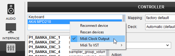

In External MIDI-Clock (LED of PAD Nr.15 is On) , the triggered actions are repeated based on the Tempo sent by VirtualDJ (comes from the Master Deck). In order VirtualDJ to send MIDI-Clock to the device, it needs to be enabled from the Controllers tab of Settings by right-clicking on the MPD218.
