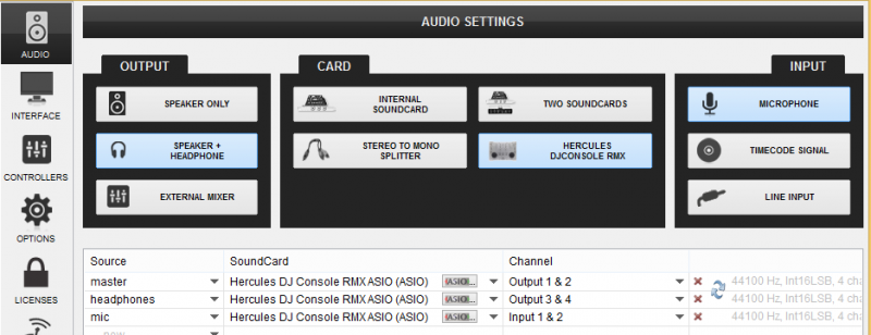

Hey all can't get my hercules rmx console to work properly. .
My wife bought my v dj 8 for Xmas and I've been trying to get it to work..When I turn my system on and pick a song can't only hear the one song on the headphone and when I try to fade in and out I hear both songs playing. .I need help with the set up so I can hear each side individually thru my speakers.. having a hard time please help
Posted Sun 08 Feb 15 @ 12:20 pm
This is the audio configuration you should use (and VDJ should have suggested when it detected the controller at first launch):
Then simply make sure your speakers are connected to Output 1-2 on the back of the unit, and your headphone to the headphone connector of your choice.
