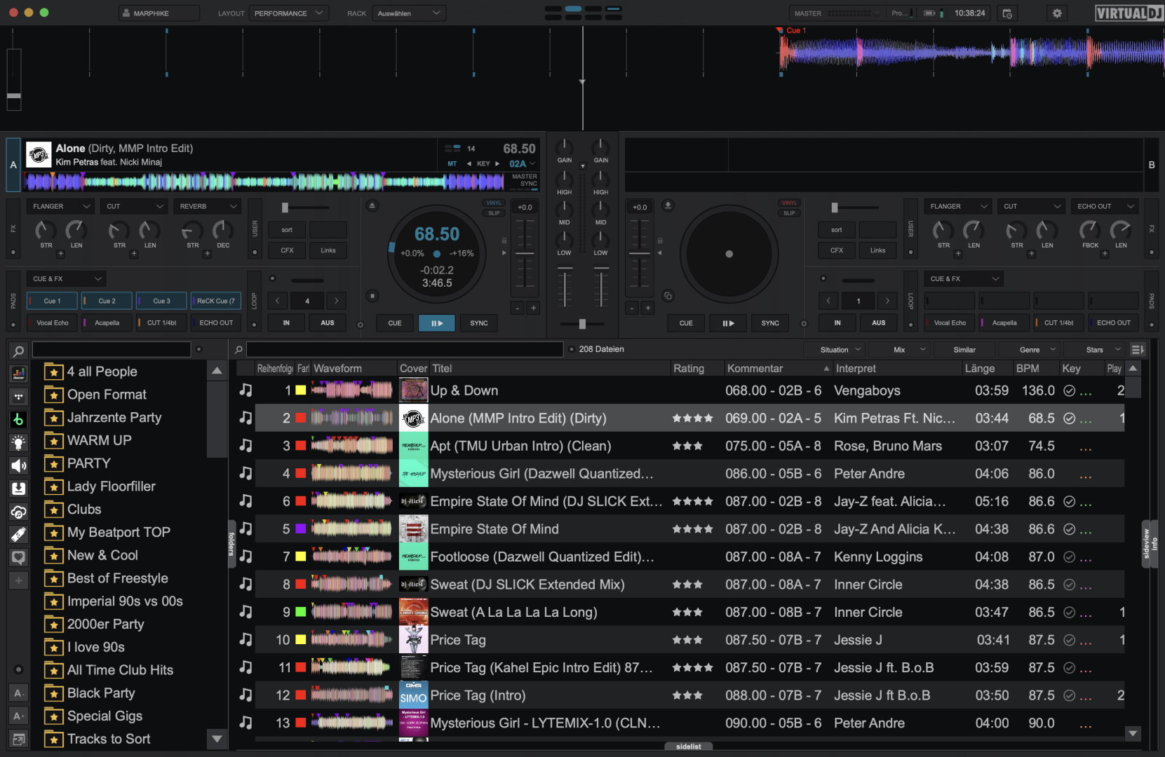

when I use the jog in the negative direction as shown in the image, you can see that it is shown correctly in the software. on the screens of the standalone units it isn't the case. it only "scrolls back" to the very first beginning of the track (time: 0:00:0) even if you use the jogwheel to go to -0:02.2. That makes it hard to know when the track really starts if you rely on the screens of the units.

No. That's a limitation of Pioneer controllers. They cannot move the waveform in negative time (time before the track starts)
PS: VirtualDJ does not "paint" the waveforms directly on the screen. Instead, it sends the entire track's waveform data when you load the track, and the controller/CDJ will place the correct area on screen based on the "elapsed" time of the track.
Unfortunately, the firmware of those devices does not accept "negative" elapsed times, and therefore it cannot position the waveform further back in time as the GUI does.

Thanks for the quick reply.
Ok. I saw that the screens on the jogs are going negative. this could be a workaround for me than. I should use the jog displays.
I think if you limit it in vdj it gets more confused because normally you need the negative amount to scratch in. if you limit the amount you don't see where the "playhead" really is. exactly this is the problem on the standalone screens.
