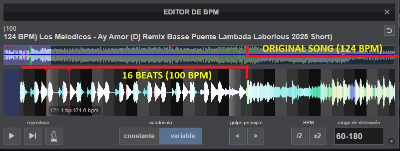

Hi, my question is: how can I configure variable BPM so that my songs detect the BPM from the very beginning for the first 16 beats and then switch to the song's original BPM?
I've tried several options in the settings, but the red anchor points when analyzing the song always show 124 BPM, which is the song's original speed, and it doesn't detect it during the first few beats I need.
I also can't move the red anchor point to enter the BPM value and adjust it.

Move the anchors by holding down shift then clicking. Adjust the tempo by moving the divisions to the right of the anchor. I would suggest placing an anchor at the start first, then one where it switches to 124.
