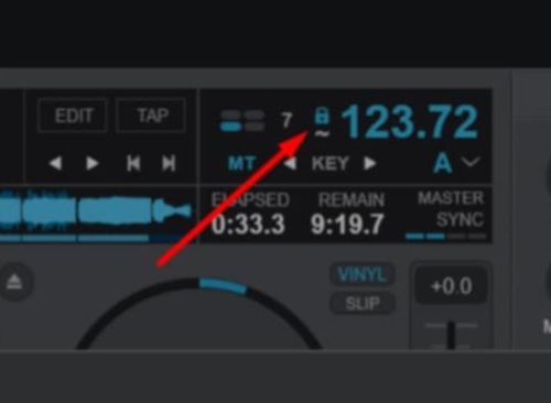

one last question... when I add a song to the deck... and I activate the lock... when I add it back to the deck it deactivates and wants me to press it again... is there an option to keep it in memory so I don't have to press the lock every time I put the song on the deck?
anything that syncs the track will also, enable the "LOCK" for a fluid track
So smartPlay would automatically "LOCK" the fluid track.
And that may not be the best, as that will lock the entire track to the BPM of the start of track, which may not be best if there are large variations in BPM in the Track, from the initial BPM.
(without the track locked, one can see the BPMs displayed on the deck's platter as one plays the track, locking at any of those BPMs will adjust the entire track to that BPM that at that position, it is pressed/locked)
One can "LOCK" (UNLOCK), the BPM of entire track and not have the grids synced, with the script bpm_stabilizer in a custom button.
SYNC button will do BOTH, align the CBG and also "LOCK" the BPM (turn on bpm_stablizer) for a Fluid Gridded track.
OR and any time the entire BPM of the fluid track can be LOCKED the current BPM (with the bpm_stablizer custom button, and then beat match that as one would any rigid (fixed BPM) track.
(this assumes that the fluid beat gridding, found all the variations, and placed the grids on the beats well)

If you always want something to happen when you load a track, script that in ONSONGLOAD.

wanted to mention, the custom button bpm_stablizer, is not really necessary, since the "LOCK" icon, is that same button, that turns bpm_stablizer on/off, when clicked.

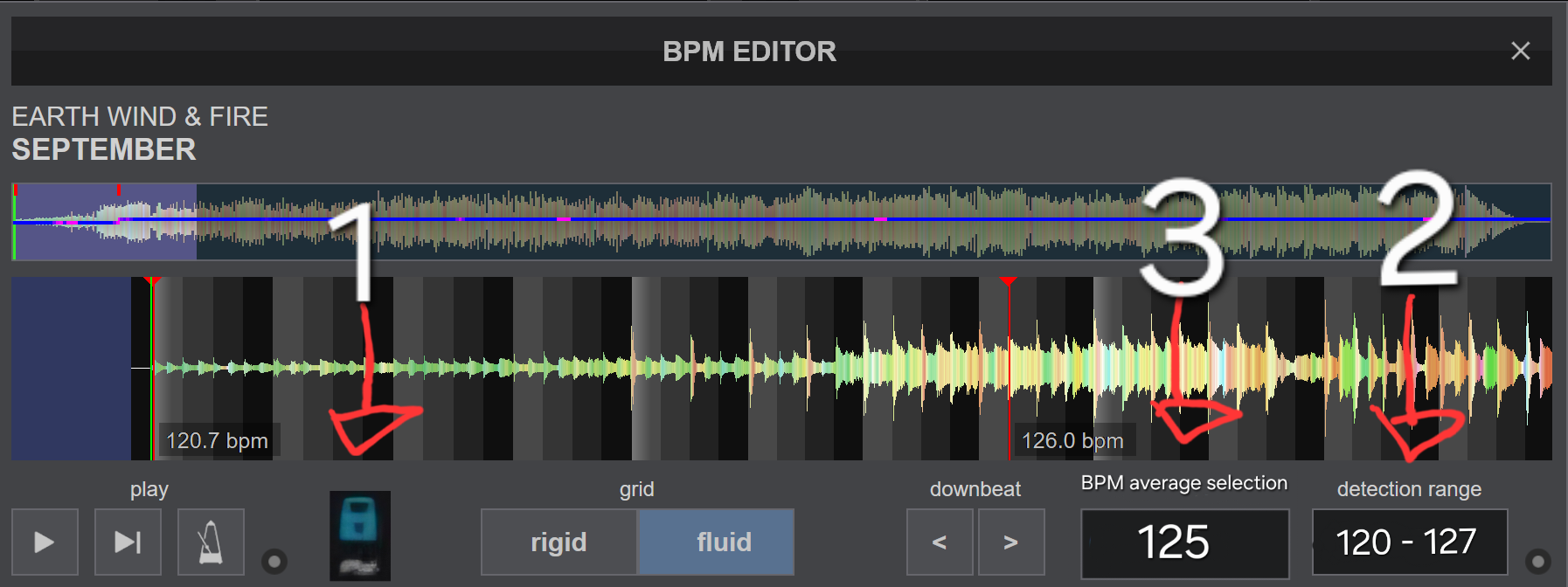

I would suggest an idea... to add an option to the bpm editor where we can choose at what bpm the song should play... for example if a song is 120, then 125, then 121 then 120... to choose at which bpm to lock, for example at 125 permanently and not let the program choose on its own... rekordbox has something similar where you choose on the decks at how many bpm you want all the songs you add to play... to put something similar in vdj but for the bpm editor.
1.permanently locked to each song..
2.song BPM range indicator.
3.average BPM option.
example...
example...
