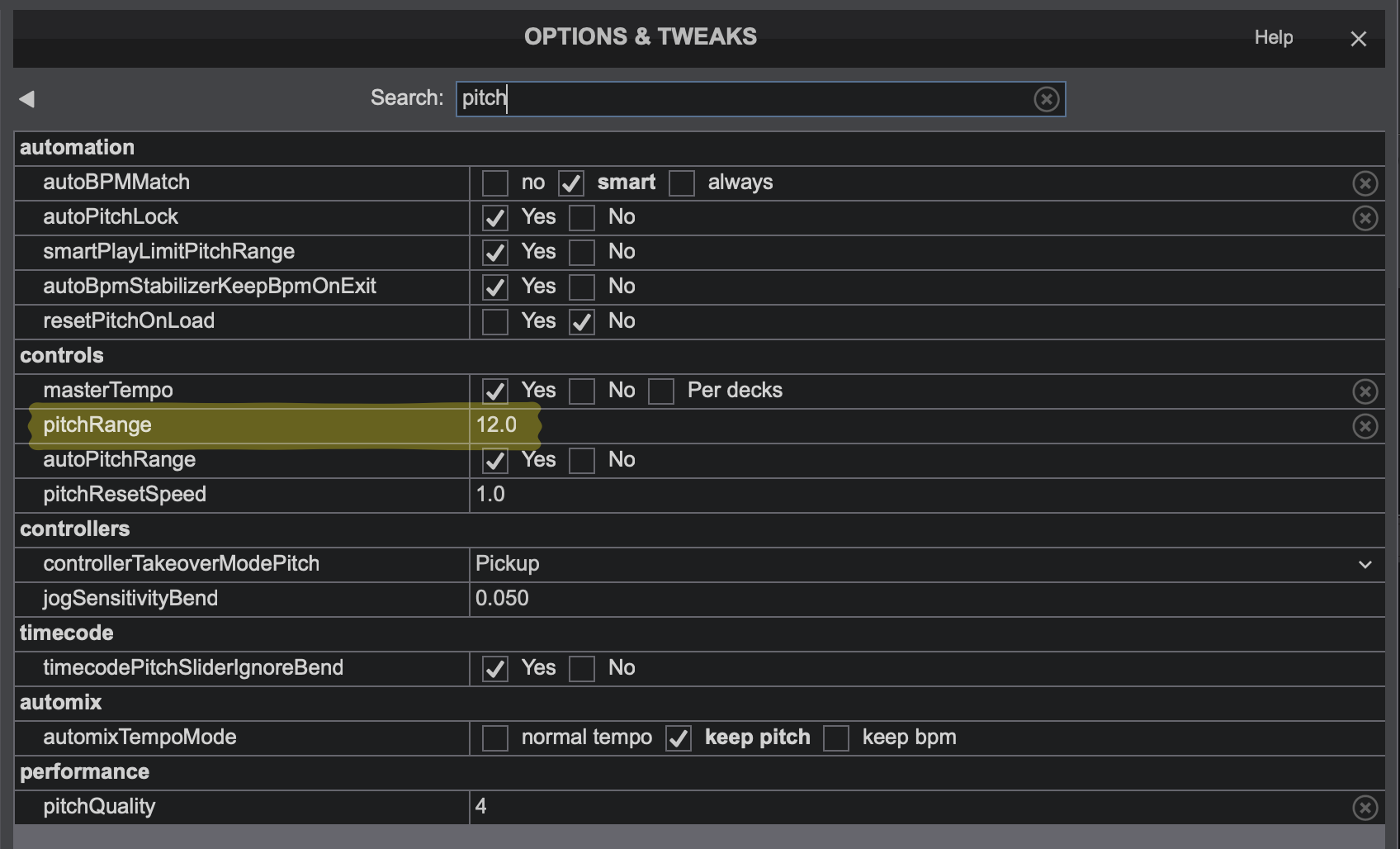

Pitch Range seems to have a mind of its own. Setting reflect 12.0 but this will wildly update to much larger ranges, all on its own.
How can this pitch range be locked and not allow the system to override it?

The answer is right below the option you highlighted (set that to No).

[face_palm]
Literally right under my nose.
[/face_palm]
Thank you!
