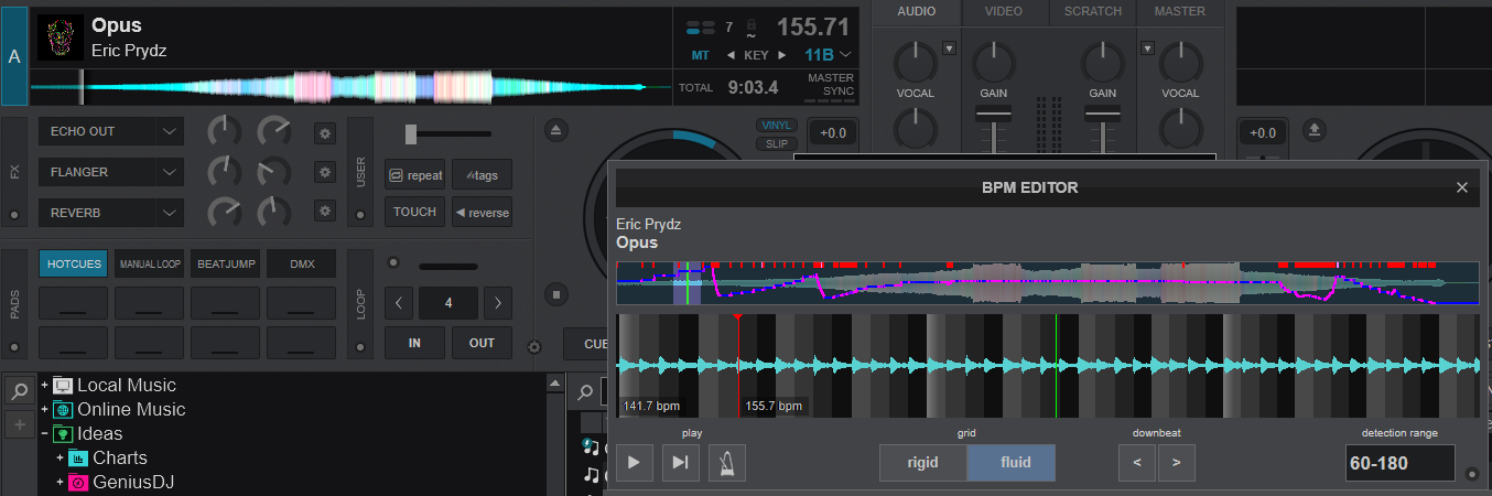

groovindj wrote :
I've not seen them displayed elsewhere - even in the editor, many tracks now just show one anchor, one BPM and a straight blue line. Yes there are sometimes red areas, but even if you zoom in on those areas, it doesn't always show you a BPM value there.
I see what you mean (I just loaded Jimmy Cliff - The Harder They Come and saw there are red areas with no marker), but doesn't that mean the BPM change isn't significant enough to require a marker/actual BPM display change?
It seems like if the BPM change is significant enough (tolerance value unknown), it will display a change (other areas of the song do display the change in the deck info area for me). I would say another explicit setting for that would solve the problem but I wonder if that does more harm than good for the average user.

I'm quite happy with the fluid analysis, but I wanted to report a terrible result with "Opus / Eric Prydz" track:
I tried to narrow the analysis to 100-140 BPM range, but it wasn't better.
How should I deal with such a track?
Posted 2 days ago @ 9:40 pm

@JeromeIP I think you found the best (worst?) possible track to challenge the system LOL 🤣
IMO that's not the sort of track that would be mixed into or out of anyway - at least not the ambient sections.
The centre part is what would be played for the dance floor.
It does seem that the system really struggles to understand things when there's no beat.
Posted 2 days ago @ 10:13 pm
Honestly (since I know and play the specific track) how would you mix it and you need the fluid analysis? Previous summer That I saw Eric Prydz live and played Opus event he played the original version and mixed it as fade in/out.
Overall I think that this thread is more of "lets pull the Fluid analysis to its limits even though that we would not use it that way" ..Anyway from the previous state that we had the multi scan, fluid is for sure way better in 95% of all the situations and 100% in the way that we were mixing in the past all of the "difficult" tracks..
and I personally am thankfull for it!
Posted yesterday @ 9:50 am
Yeah agreed. I had a long play with it last night and it mostly worked well, certainly enough to rely on if needed live at a gig.
Seems it's turning in to a let's find the most difficult tracks you'd never mix anyway with the BPM to 0.0001 percent accuracy competition.
Remember this for "live" use as a DJ and not to picked apart in your studio at home.
Posted yesterday @ 10:23 am
Rember:
Fluid is to be used to help you mix difficult parts where the song(s) drift (if you have to mix on those parts)
This means that most likely at the place you're mixing you have either a steady tempo (that may be different from the tempo of another location of the song), or a tempo that's gradually drifting/changing (and not being a roller coaster). It also means that most likely you'll try to make a quick mix, and not keep mixing for 64 or 128 beats as if the track(s) were 100% rigid.
Fluid is not meant to be used as a tool to create realtime perfect mushups of drifting tracks that will stick to a 100% stable CBG grid.
I suppose yes it can be used for that too, but it's not what it was designed for and therefore limitations exist. You need to try beforehand, and decide if the result is good or not. But still this is not the primary function of Fluid. Rather a sideshow of it..
Finally if you "stabilize" a fluid track for long enough, of course and it will sound strange, especially if the drifting and/or tempo changes of the original track are significant. It's what people have been talking about warping since Ableton made that a thing..
BPM stabilizer is just a limited scope warp mechanism. So yes, stabilizing an entire track to a given BPM should be used extremely wisely.
Posted yesterday @ 10:54 am
