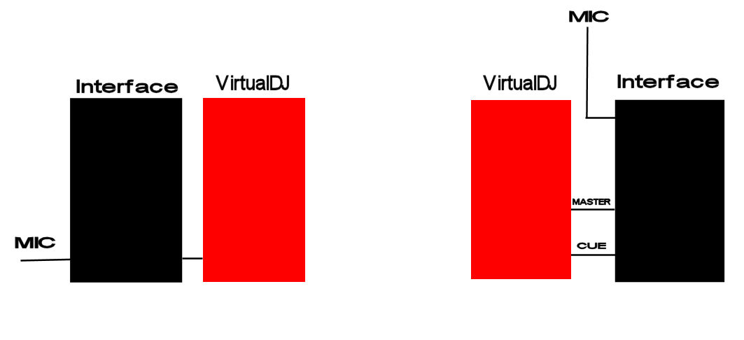

OK so recording into Audacity is not what you're doing with VDJ. Gotcha.
I guess the delay is caused by you running the mic through the VDJ (software) mixer then, rather than directly through the interface. Ideally you'd want an interface with more channels, so you could have a master output, a cue output and a direct mic input.
I made a thing!
Rather than the scenario on the left, you want the one on the right. You'd set up the output of your interface as the record signal in VDJ.
I made a thing!

I'd suggest you need to avoid running a mic of any kind through the software, to reduce the likelihood of delays. Using a USB mic would likely make any delay worse.
A typical DJ controller as used by many here would have an onboard audio interface and a direct mic input. It provides a config similar to the one on the right. That's what you need to aim for.
