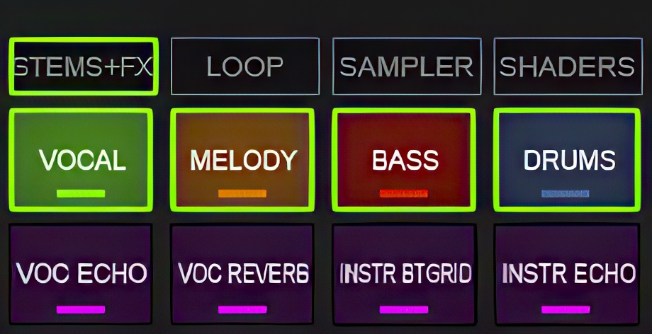

There's already a pad for this which you can adjust yourself
Posted 12 hours ago
