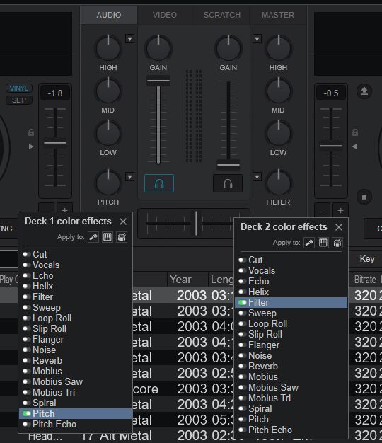

Installed 2026 over the latest version of 2025 (auto update, not a fresh install). Every time I start VDJ, Deck 1 Pitch in the Deck 1 Color Effects dropdown box (on the audio tab, to the right of the bottom knob) is on and somehow set to about 4 semitones higher than flat. I'll turn it off, restart VDJ and it will be turned back on. I've checked ONINIT. There's nothing there. I don't know where else to look that would be automatically turning this button on upon VDJ start.
Also, none of the other buttons in the deck 1 color effects dropdown work. They do not turn on. Just the pitch.
Now, in deck 2 color effects dropdown, only the 'filter' button works, but not the pitch or any other buttons. I'm genuinely stumped.
Any help is appreciated. Thanks.

The issue has been acknowledged and a fix will come within the next few hours
Thank you. For once, it's not just me :)
Curious though. Was another topic started for this issue? I do a quick scan of the latest posts every morning and didn't see this issue.
