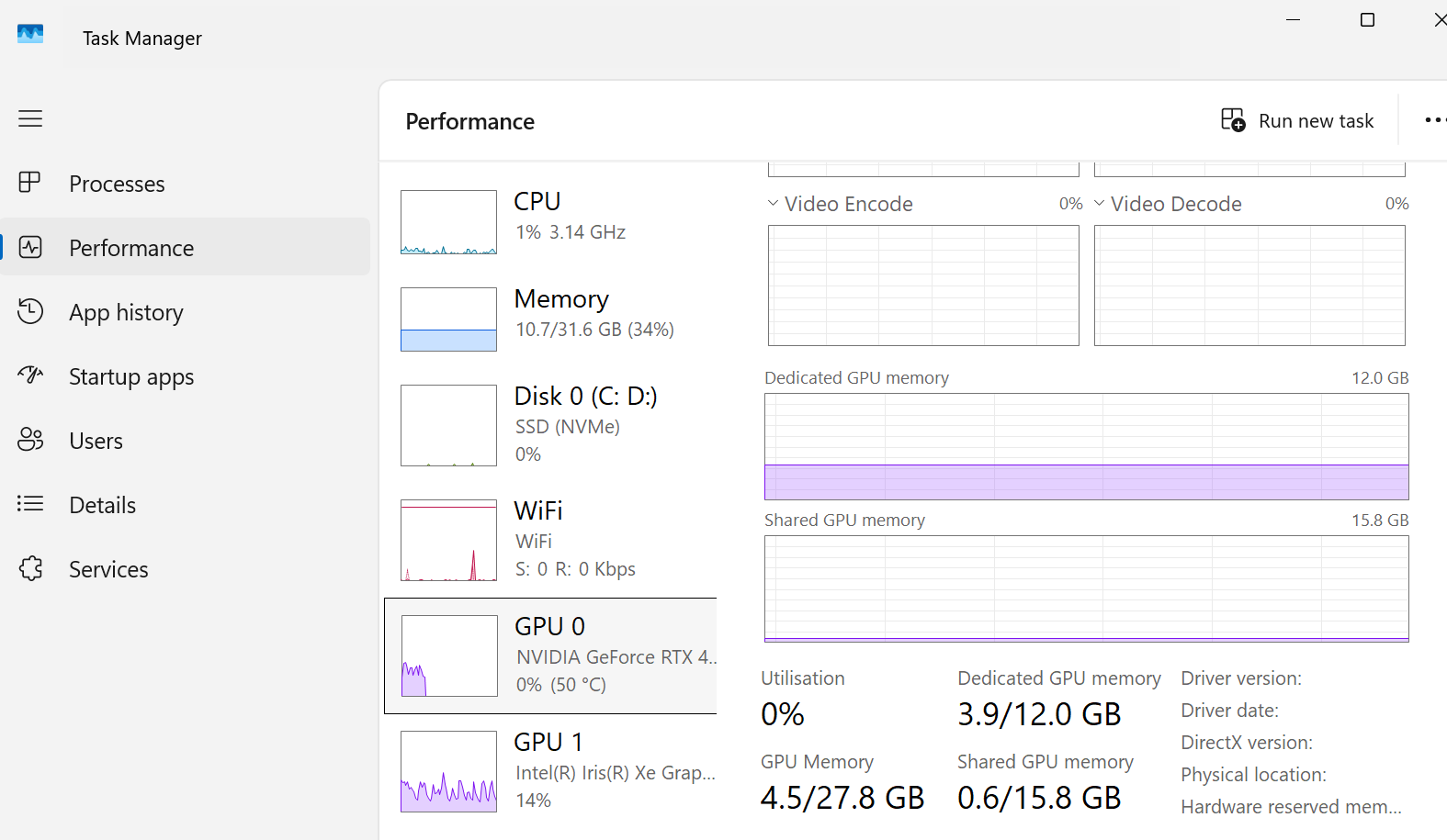

I just tested here with mobile RTX4080. I have stems set to fully disabled as I precompute them when required for export to my low powered DJ machine.
Created stems for 4 files, and memory used as per shot below. It was zero before I started calculating the stems. When it finished calculating the memory did not go back to zero and was locked. Only when I closed down VDJ did it clear back to zero. You can see that the utilization on the card was zero but the memory was still being used with no stems being processed.
OK, interesting. Thanks for doing this. I wonder why it locks up the memory after computing stems. Wonder if it's a Windows reporting error or if VDJ is actually hanging on to that memory after it computes stems.
