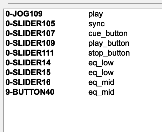

Im trying to map a usb controller to the interface,
I mainly just need the pads for Cues, stop, play, Sync ect. I thought was as simple as hitting a button and using the gui to place the function or typing in the desired command. When i do so the inputs do nothing. Am i missing something. at first i though maybe i need to select a deck, i did put still nothing triggers. Any help is appericiated.
here is what have so far.

I don't know how you arrived to this, but using "slider" MIDI element for what should be a button, and "button" MIDI element for what should be a slider, is not going to work properly.
Most likely you need to create a device definition.
Do you have it's MIDI chart ?

those were the values i was getting when i pressed the buttons, i thought that was odd!
The more i read up on it, i did arrive at a section about creating a device definition. No midi chart. I kind of just said F' it after that, and bought the serato reloop controller works right out of the box.

page 34
https://files.bbystatic.com/%2BOriTwk9PHGbgjI2EYT2Ew%3D%3D/9A30FA4B-234D-4A8A-9A6A-68E2727FD17B.pdf
pads on ch10, dials on ch 1, other buttons ch 1 [presume they're indexing from 1]
