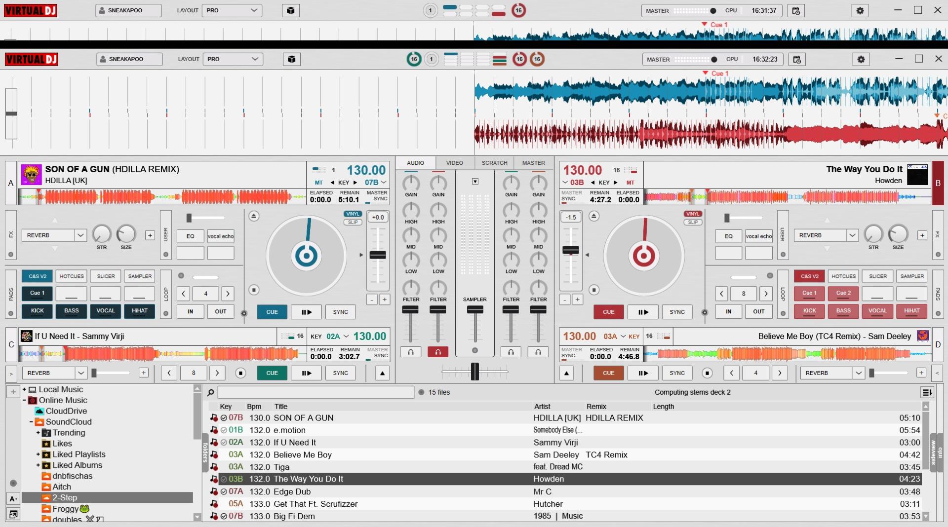

Yes, if you set it to 4 decks in the layout dropdown you get the pro skin with 4 waveforms at the top and 4 deck waveforms. Only the scratch waveforms are then limited to 2 waveforms:
Posted Tue 15 Apr 25 @ 1:44 pm

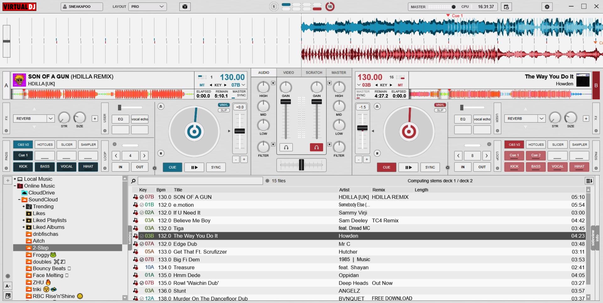

Thank you for your reply!
What you have is exactly what i want!!
However, there must be another obscure setting that hides/displays the waveforms.
When I select the 4 decks option it shows me the 4 decks but it still only shows the 2 waveforms!
You can see on my attached photos, i have 2 decks and 4 decks, and on both it only displays 2 waveforms!

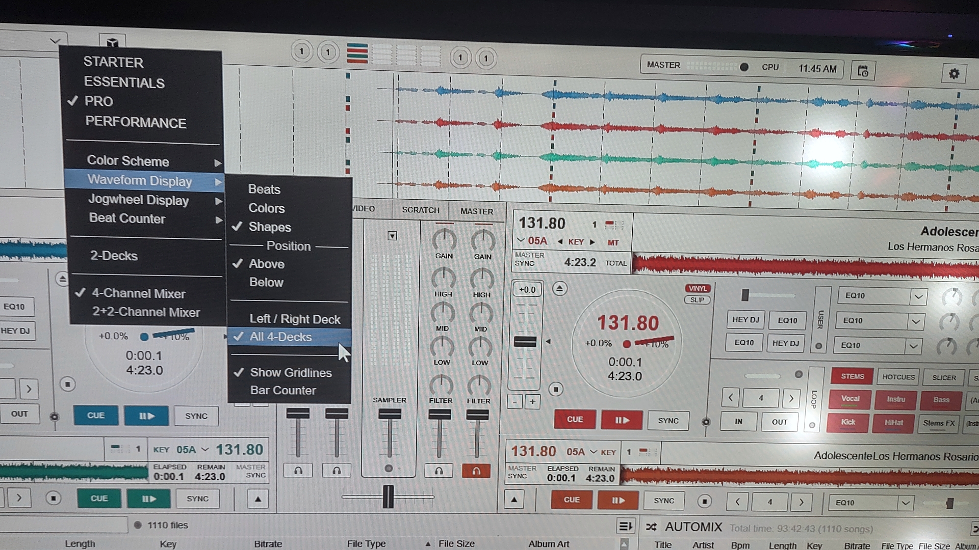

managed to find it!
when you switch to 4 decks from the dropdown, a new option appears on the waveform dropdown that allows you to display all 4 waveforms (so 2 separate settings).
once again thank you for your reply. the fact that you showed me it was possible made me believe and find the solution! :)
Posted Tue 15 Apr 25 @ 3:48 pm
hope this help.!!!

FD-SALSOUL-DJ wrote :
hope this help.!!!
yes! that's the option i couldn't find! thank you!
