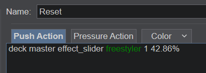

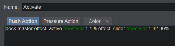

Posted 2 days ago @ 6:02 pm
when everything is connected in the working condition, when pressing pad 6 or 7 (reset / activate) is when the ghosting on the effect slider appears. I can get rid of it by cycling up and down the slider (pads 5 & 8) away 1 step from the ghosted point, but then returns if i press reset again.
Posted 2 days ago @ 6:14 pm
use
deck master effect_active freestyler on & param_multiply 3 `get_constant 7 & param_1_x` & param_cast & effect_slider freestyler 1
and
deck master param_multiply 3 `get_constant 7 & param_1_x` & param_cast & effect_slider freestyler 1
and
Posted 2 days ago @ 6:32 pm
your code has cured the ghosting. thank you. as you can see, mine was a complete guess....

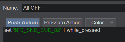

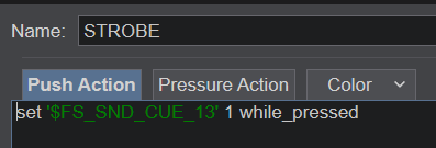

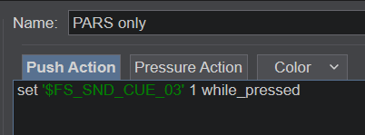

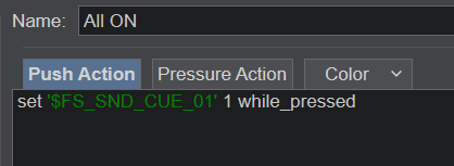

Posted 2 days ago @ 8:21 pm
I've been testing everything with connecting the controller after VDJ has loaded up and everything seems to becoming together.
One observation I have made is that the pads (1 - 4) only stay illuminated whilst being pressed, therefore I'm unaware of which dmx cue I'm running without looking what the lights are doing or flipping over to freestyler.
I've had a go after a bit of research but not near my kit to try, would changing the code to the below keep which ever pad was pressed to stay illuminated and turn off the rest?
(ie, press pad 1, it illuminates, press pad 2, pad 1 goes off and pad 2 illuminates etc...)

(dmx-pad 'All ON' on : dmx-pad 'PARS only' off : dmx-pad 'STROBE' off : dmx-pad 'All OFF' off) & set '$FS_SND_CUE_01' 1 while_pressed

(dmx-pad 'PARS only' on : dmx-pad 'All ON' off : dmx-pad 'STROBE' off : dmx-pad 'All OFF' off) & set '$FS_SND_CUE_03' 1 while_pressed

(dmx-pad 'STROBE' on : dmx-pad 'All ON' off : dmx-pad 'PARS only' off : dmx-pad 'All OFF' off) & set '$FS_SND_CUE_13' 1 while_pressed

(dmx-pad 'All OFF' on : dmx-pad 'All ON' off : dmx-pad 'PARS only' off : dmx-pad 'STROBE' off) & set '$FS_SND_CUE_02' 1 while_pressed

Posted 2 days ago @ 12:44 pm
nope dmx-pad isn't a verb, and LED logic doesn't work like that, maybe something like this
PAD 1
( var $dmxPadLED 1 ? on : off ) & set '$FS_SND_CUE_01' 1 while_pressed & var $dmxPadLED 1 ? set $dmxPadLED 0 : set $dmxPadLED 1
PAD 2
( var $dmxPadLED 2 ? on : off ) & set '$FS_SND_CUE_03' 1 while_pressed & var $dmxPadLED 2 ? set $dmxPadLED 0 : set $dmxPadLED 2
PAD 3
( var $dmxPadLED 3 on : off ) & set '$FS_SND_CUE_13' 1 while_pressed & var $dmxPadLED 3 ? set $dmxPadLED 0 : set $dmxPadLED 3
PAD 4
( var $dmxPadLED 4 ? on : off ) & set '$FS_SND_CUE_02' 1 while_pressed & var $dmxPadLED 4 ? set $dmxPadLED 0 : set $dmxPadLED 4
Posted 2 days ago @ 1:09 pm
worked a dream!
pad 3 needed a bit of reconfiguring as 1 & 3 lit and 3 didn't activate strobe, however, easily sorted looking at the others.... starting to slowly pick bits up now lol
