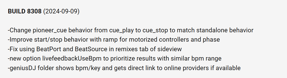

I asked the same question to VDJ help, this was the answer I wasn't expecting 😲.
Jimmy (VirtualDJ)
Jan 17, 2025, 17:24 GMT+2
Hello,
For Pioneer controllers the cue button behavior has been changed in the latest update in order to behave the same as Pioneer stand alone units:
When the Deck is paused, you can set a temporary Cue Point by moving the Platter to place the Audio Pointer at the desired location and then pressing the Cue Button. During playback, you can press the Cue Button to return the track to this Cue Point. (If you did not set a Cue Point, then it will return to the beginning of the track.).
If the Deck is paused, you can press and hold the Cue Button to play the track from the Temporary Cue Point. Releasing the Cue Button will return the track to the temporary Cue Point and pause it. To continue playback without returning to the Temporary Cue Point, press and hold the Cue Button, then press and hold the Play Button, and then release both buttons. <------
Jimmy (VirtualDJ)
Hello,
Posted Tue 28 Jan 25 @ 4:39 pm
Was last September so not the latest version.
Posted Tue 28 Jan 25 @ 5:02 pm
