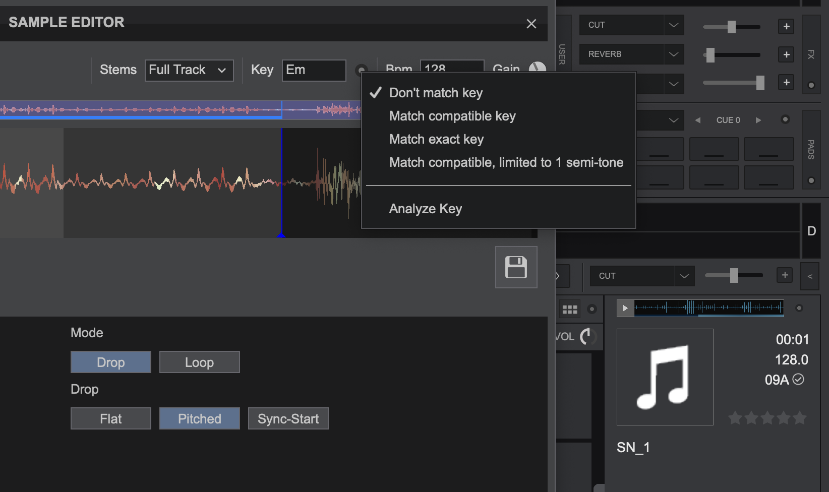

I'm struggling with some issue related to sampler "pitch" effect. My goal generally is to have same sample played in different key - "pitched". E.g. I have sample in key "Am" and I would like to play it in key "Bm", "Cm", "Dm", "Em", "Fm", "Gm".
First I tried to manipulate the Key option in Sampler Editor as shown below - however independent on this which key I provide there and which key match option I select - I do not see any difference in sound. Even though I change track key it has no impact on played sample.
