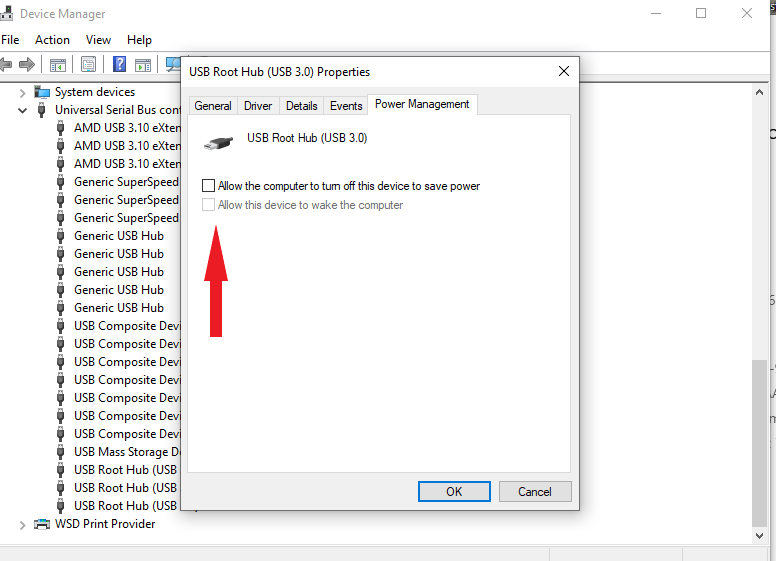

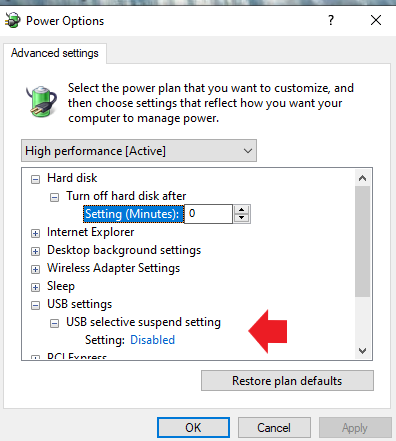

Are you media files on an external USB disk of some kind
If so have you done the USB power things?
Turn this OFF on every single USB device that his it in the device manager, doesn't matter if you have anything connected to it or not. Sometimes Windows updates can turn this back on, so being vigilant is key
and
Do this in your Power plan under the Power control panel.
