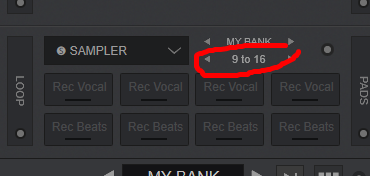

another possibility I can think of, maybe your bank has more than 8 slots, and you have samplerSpanAcrossDeck set to yes (which is default when upgrading from vdj2024), so that the bank on deck 2 is showing samples 9-16?
Look on the skin in the pad section, if you see 9-6 under the bank name?
Posted Thu 05 Dec 24 @ 11:46 pm
