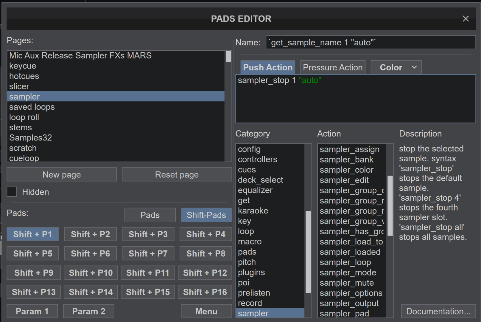

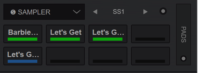

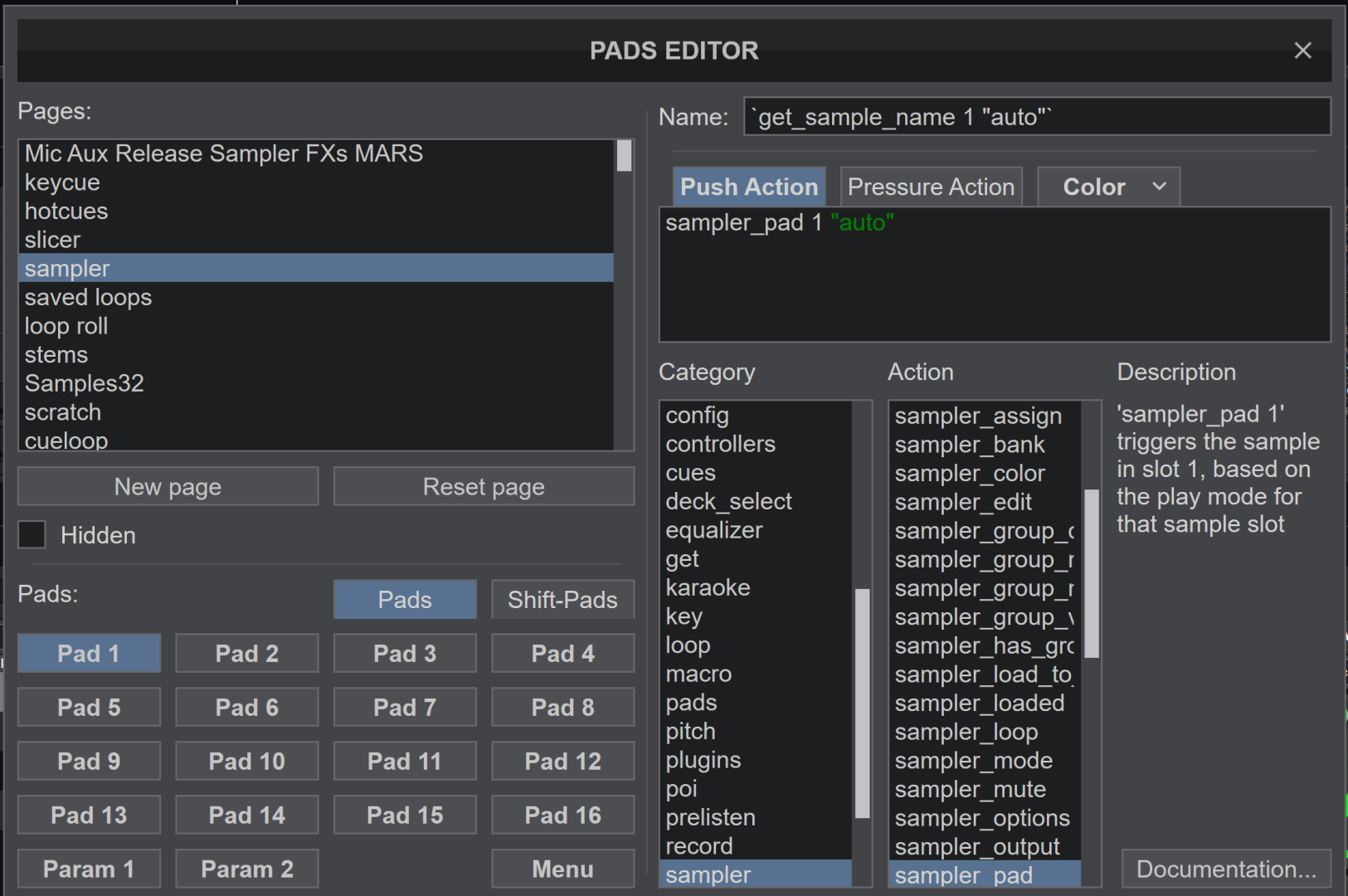

6) here is quote from the link posted above this post:
I have the bank unlocked. (since I can record in the slots)
Both the "Rec..." and the R-clicking delete are not as described.
Is it possible that the NEW sampler padpage did not get changed during the update process?
below is the some screenshots of the sampler and sampler padpage editor:
It does RECORD and create the stems samples. (just NO Rec.. indicator on empty slot)
NOTE:
the R-click (shift action) would indicate the sampler stop... which is what it does . . . NOT delete
is there way to get maybe the updated sampler padpage, if it is not current
Stephane Clavel wrote :
a little more detail on what is StemSwap sampler, and how it works:
2) when a bank is "unlocked", the pads that don't have a sample assigned, will show "Rec..".
Clicking on such empty slot, will instantly record a loop from the playing track on this deck.
Righ-clicking (or shift+pad) on an existing slot, will delete the sample so you can record a new one.
NOTE: you can change what is recorded (drops vs loop, and size of loop) in the sampler menu.
NOTE:
8462
Click on the "reset page" button, if you modified it
Posted Mon 02 Dec 24 @ 9:58 am
Thanks so much,
that solved the sampler padpage, as it now works perfectly, as you have described.
