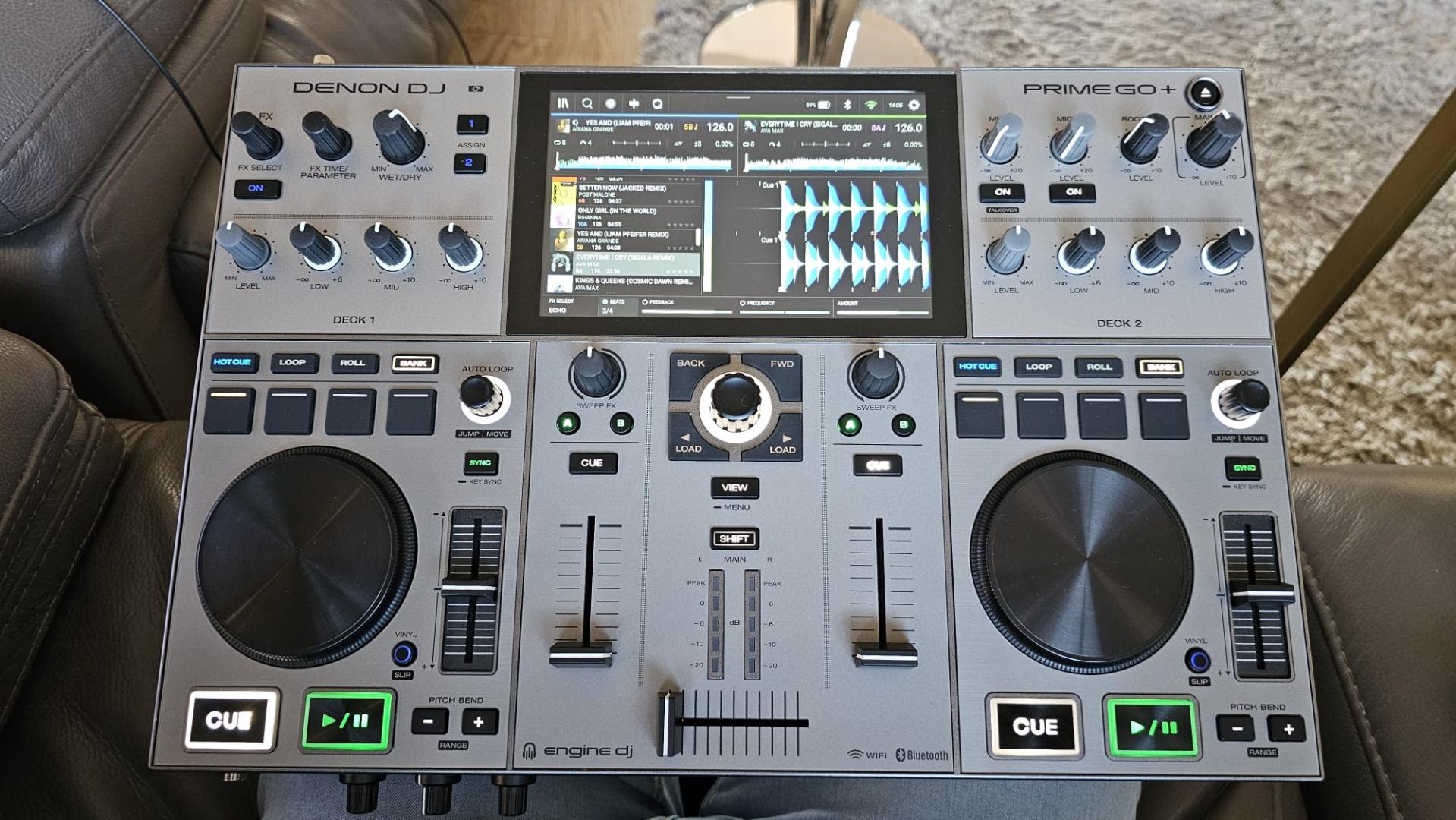

Denon Prime Go+
Booth out is jack rather than XLR but that's the only thing. No DJ controllers have a separate subwoofer output.
No mic EQ either but again that's a personal thing whether you need it or not.
Works perfectly with VDJ and it has the Denon Engine standalone too so depending on the gig you wouldn't need a laptop either.

Things have moved on. Many DJs now have dumped all the 19" rack mount stuff, and controllers usually include a mixer section.
You won't find much current DJ stuff that's rack mountable.
The Denon Prime series are designed as standalone DJ playback systems that don't require a computer, so if all you need is a controller for VDJ, it's overkill.
You're unlikely to find a controller with three mic inputs, but two is fairly common (although not always both as XLR). Something like the Rane Four maybe?

Thank you for the replies.
I guess since so many others have viewed this thread but nobody else commented, the Denon Go is the way to go. I know it has mixing capabilities but I will probably still add the Mackie to cover those moments when I need more inputs and perhaps some vocal effects. (Karaoke).
Thanks, again.
Thanks, again.
