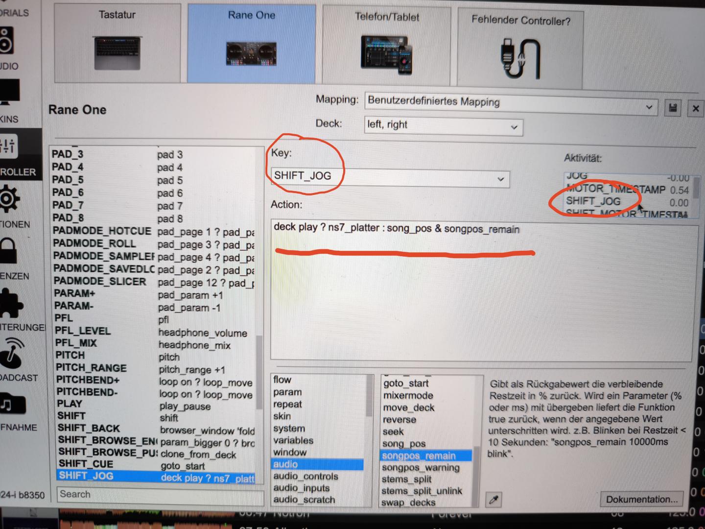

I'm looking for a script that allows me to scroll through the song using Shift and Jogwheels in the selected deck.
Procedure: I load a song in deck A, press Shift and turn the jogwheel and scroll in the loaded song. Like Pioneer Controllers.

OK, thank you for the fast answer. For my Controller doesn't work, because it's a Rane One and have spezial Jogwheels. After a lot of time, I scripted:
Key: SHIFT_JOG
Action:
deck play ? ns7_platter : song_pos & songpos_remain
This script, works for me, if I press Shift + touch the jogwheel it scroll in the loaded deck with the new song .... (Condition deck doesn't play, if the deck with the new loaded song is playing, function is not active. Otherwise it makes no sense to me )

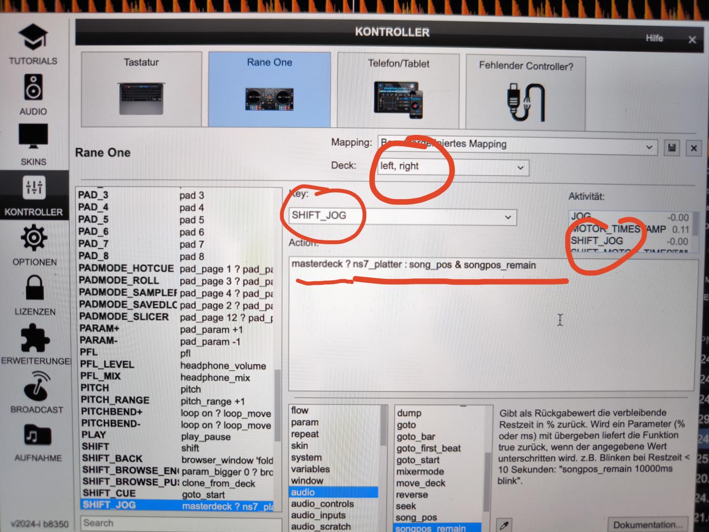

Update:
Okay, I changed the "play" to "master" in the Action. Now it make no difference if the deck (where you load the new song) is playing or not. So you can needle search "on fly", very fast, in the song with shift and jogwheel. This script works only right with a 2 deck controller

Yes your are right, my update does not work, sorry for that....
The Problem I have, is, that if I press only Shift now by playing deck , it jumps around in the loaded song. I don't know why (Script: Just do this.
song_pos & songpos_remain) .... If the deck doesn't play and I press Shift + Jogwheel it scroll in the song....
