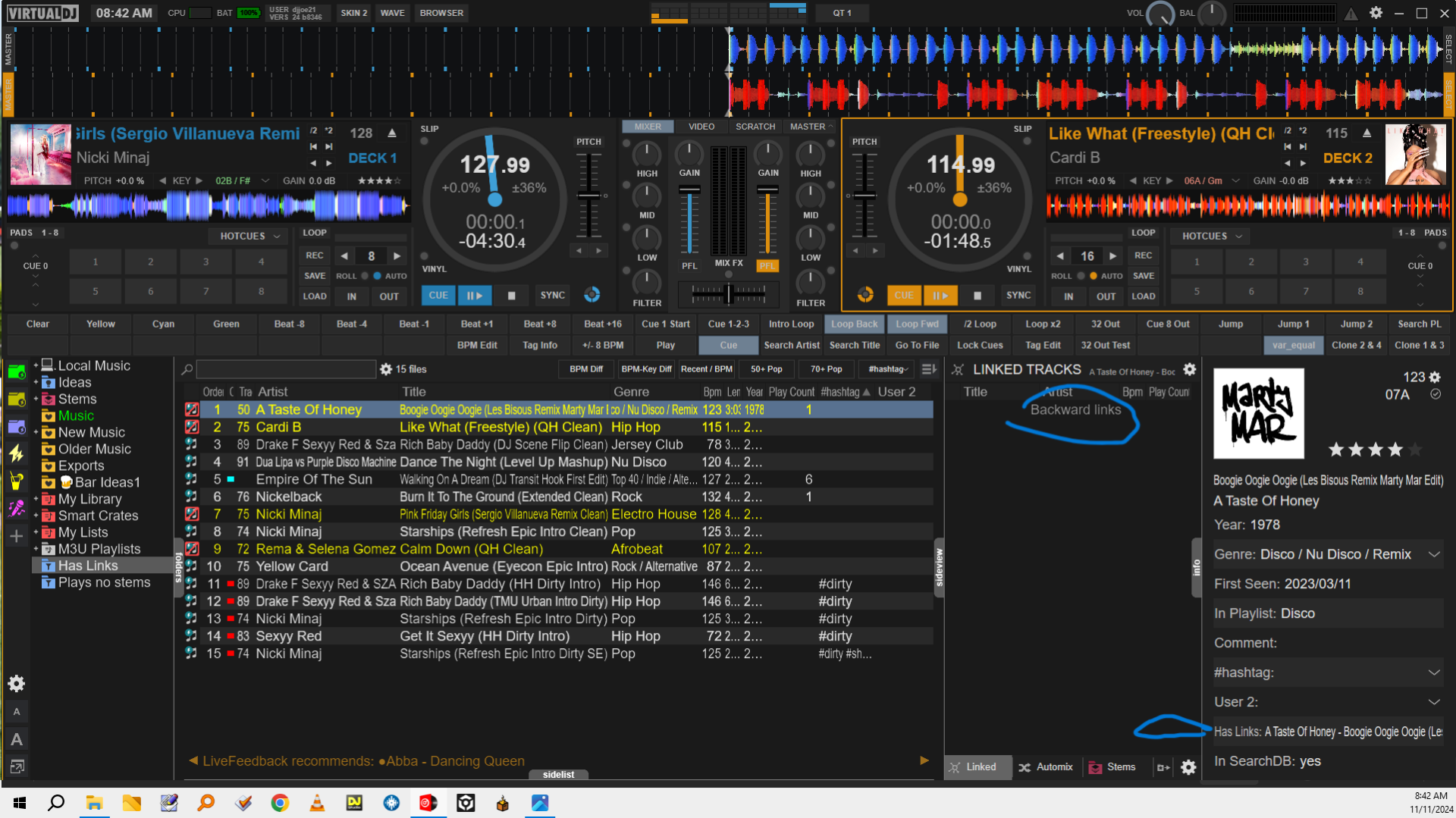

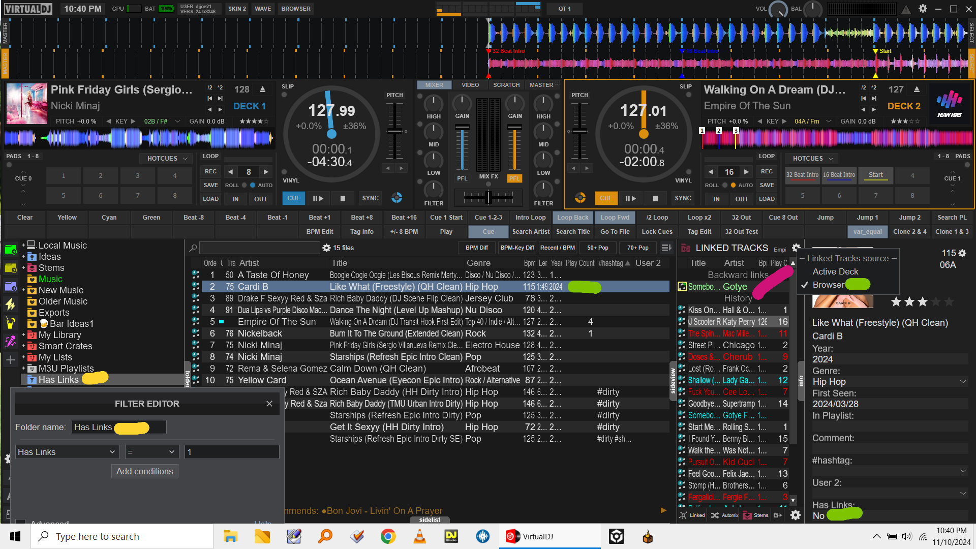

So I am looking to link up some tracks and before I started I setup a smart folder to just make sure I didn't have any linked track. It showed I had about 50 which I assume I did with accidental dragging & dropping because I didn't link any tracks on purpose. I was able to figure out most of them and did unlink them. But I still had 15 tracks that are saying they have links but I can not unlink them. I have a picture attached:
The Yellow marks show the smart folder
The Green marks show I'm using the link browser
The Pink mark shows a track that has been removed and still shows up as a linked track
 Edited.png)
Also any way disable backwords link from showing?
Thanks
Joe
Posted Mon 11 Nov 24 @ 3:55 am
You need to load the "backward link" track (Gotye) and remove the link from there.
Then the Cardi B track will not have any link

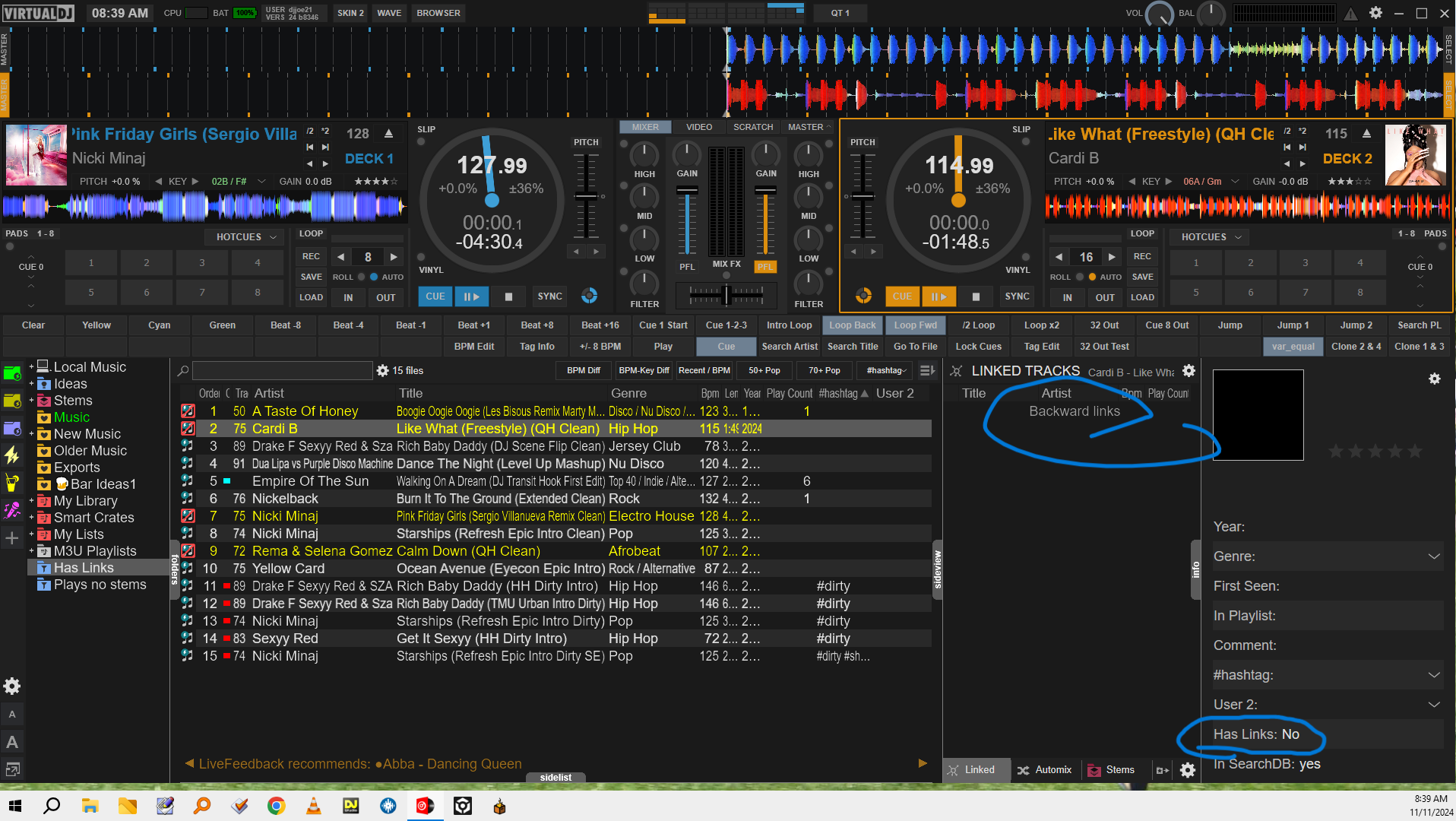

OK I have unlinked the Gotye and Cardi B songs
.png)
Yet the Cardi B song still shows up in linked smart folder and says it has no links in the bottom right
And the Boogie Oogie song is linked to itself
.png)
All the songs in this smart folder look like the Cardi B song they say they have "Backwards Links" but non show up.
Joe
.png)
.png)
Joe
Posted Mon 11 Nov 24 @ 1:49 pm

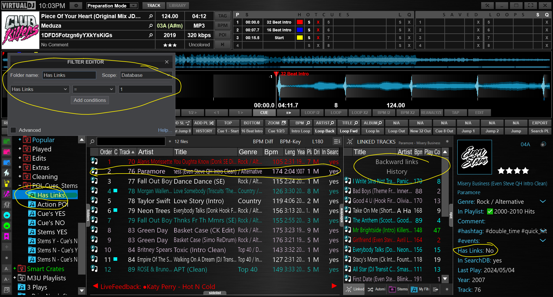

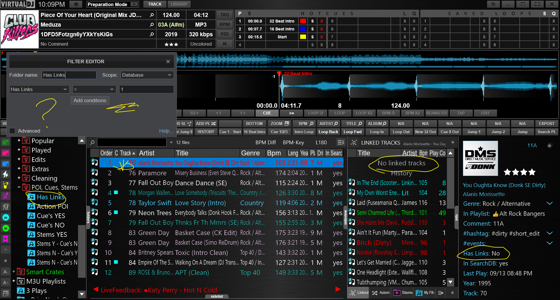

Doing some tag and DB cleanup and still seem to have some weird Links issue. This could be user error but I cant figure it out. I have a filter on songs that have "have Links" but the info screen says no links. Sideview shows only history. Some say backwards link and show none. Some say no linked tracks and still show up in the filter. I confused as to why they show up in the filter but appear to have no links
Thanks
Thanks
Posted 13 hours ago
Looks like this can happen if the track has links, but the linked track cannot be found
Posted 9 hours ago
