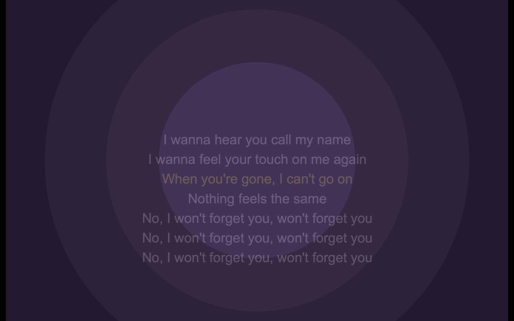

With the introduction of Stems separating the vocals and superb support of the karaoke lyrics (with .lrc file), I'm getting lyrics for pretty much all songs in my library that I can gather (just in case).
However as great as this is, it poses a problem as the karaoke lyrics will always force itself to the video feed and it will show up if you have particular master overlays like slideshow used (in this case it will be semi-visible while transitioning between slideshow frames), and I cannot seem to find an option to control that (other that removing the lyrics for the songs I play and this is not really what I'd like to do)
As I am doing mainly non-karaoke events where I sometimes do need to use the video, this is quite inconvenient. Is there (or could there be) an option in settings that will "block" karaoke lyrics showing somehow? I would put this to custom button in interface and I would only enable it if I really need the karaoke functionality. That would be fabulous.

custom_button
video_level 1.0 ? video_level 0.0 : video_level 1.0
if it's a problem video press it on deck and it will blank video output for that deck, press again any the output will restore
Oh, that's exactly what I needed LocoDog, thank you so much, you've just made my day!
