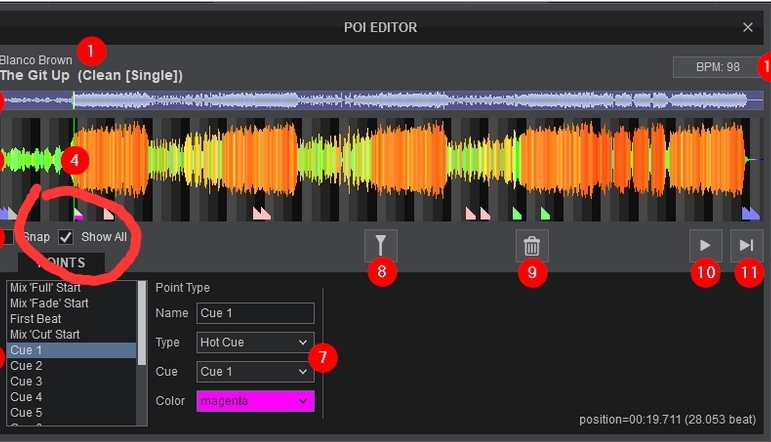

Hi VDJ adds a whole bunch of POI points which i don't want to see like the Mix 'Full' Start, Mix 'Tempo' Start etc.
1. I know if I go to POI editor I can remove show all and they disappear in the POI Editor. but I can still see the marker in the waveform display in the deck. How can I remove to not see them when playing my decks? I tried deleting them one by one from the POI editor but it will be ridiculously long to remove one by one in thousands of song files.
2. I want to add my own points and keep a consistency. When I create new I can add a marker and call it voice so I know the voice starts there. Question can I create POI markers to use on other songs so when I create POI points on other songs I can choose a marker called voice instead of retyping it all the time on every song.

          1 they're automix points they don't effect anything other than automix
if you're really retentive about it, I could regex your database as a favour.
send me a db backup zip in a pm

          Uncheck the following button (this extra points do not show in the POI Editor unless you have that checked):
As for deleting them...that's pretty much extra work and they don't really affect anything visibly outside of the POI Editor unless you specify them to show (from the same POI editor). It's probably easier to ignore then and keep Show All unchecked.
Repurposing them (rename/make visible) is a larger task, which would involve some vdjscript and still some manual checking (you might not like where they are automatically placed)

          Ah right so initially you asked me to make all automix & remix points into visible markers,
and now you just want to get rid of them.
Again it would be regex exercise.
I'm not sure of the exact regex incantation, replace all is kind of dangerous without testing.
Send me a database backup zip, it won't be hard but it needs to be exact.

          That I can advise remotely
MAKE A DATABASE BACKUP BEFORE HAND
search mode click regular expression (bottom left)
searching for
Pos="(\d+\.\d+)" Num="-1" Type="(automix|remix)"
replacing with
Pos="$1" Type="$2"
That will make them all invisible again
