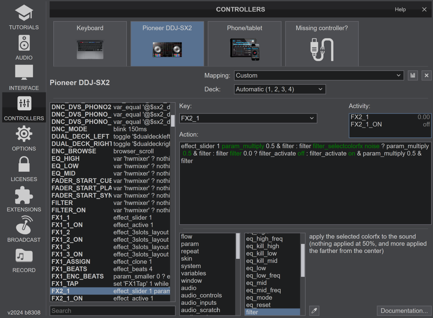

Awesome, thanks for providing the code! I tried to wrap my head around the parameters and remapped the according hardware knob. Unfortunately... it does not seem to work: The noise filter level now just doesn't react at all.

Trying to insert a screenshot...

These are the codes you wrote down... I guess I just messed up applying and combining them. Further help would be well appreciated! After another try the FX knob now functions as a low pass filter - I'm lost.

Hello again! Replying late because I just couldn't apply the custom mapping as desired. The "filter" parameter seems to switch the effect to "filter" (high pass / low pass) obviously, which I don't need because there's a dedicated HP/LP Filter FX knob on the mixer. So far, no effect on the noise filter - if you want to further help me out I'm glad to buy you a coffee or two, but maybe this is too specified and/or I'm lacking the basics in custom mapping commands :)
