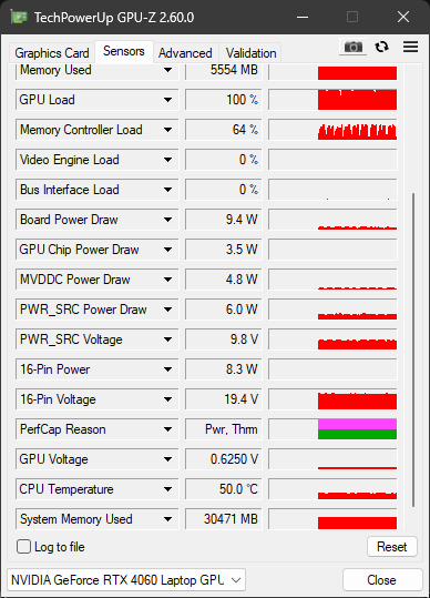

What is the speed it shows when you check the tooltip on the cpu meter?

That's indeed slower than it should be. Perhaps try something like gpu-z to check the frequency and see if it's not throttling? Perhaps a cooling problem with the laptop
Posted Sat 21 Sep 24 @ 10:57 am

While stems are processing, check the sensors tab, in particular the PerfCap reason.
If functioning properly, the power draw should be around 40W I think, depending on your specific laptop.

Infact. Your are right. I don't know if I can change this settings in my laptop.

9W seems extremely low yes, so perhaps the power plan is set to maximum battery or so?
The reason also says thermal though, not sure if higher up you can see the GPU temperature, but overheating is still a possibility in that case too

Maximum is 90W. 9W only is very strange. I'll continue investigating. Thanks
