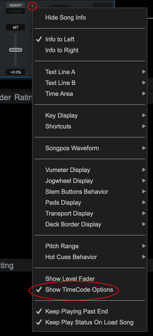

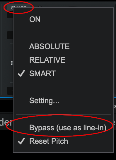

Could somebody point me in the right direction, Cannot find the (Line In- on and off setting) does not show in the custom buttons, It is there in the vdj skin, Maybe overlooking it.

Posted Sat 10 Aug 24 @ 9:20 pm
A massive Thank You for that-I also had to add timecode signal in audio settings to complete, There is no way i would have found that......
