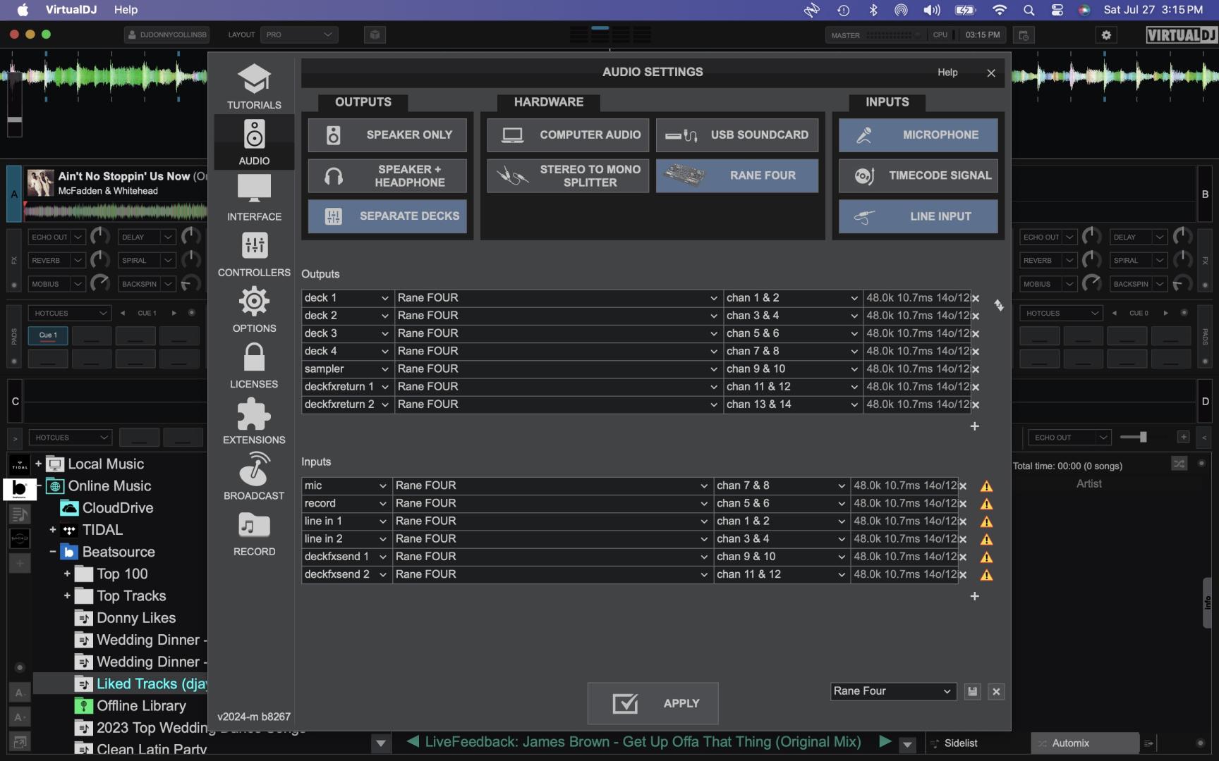

I'm on Mac OS Sonoma 14.5, Macbook Air M1 2020, most recent version of VDJ and Rane Four, also most recent drivers and firmware from Rane. When I press the SW Effects button on the Rane Four and apply an effect with the paddle, the audio mutes, except for the Mobuis and backspin effects. I've attached a picture of my VDJ audio settings. Any ideas on this?

- What is the value of the option fxProcessing?
Post Fader is probably what you want - What is the beat length of the effect you are using?
You might want to adjust that to longer.

Hey! I checked and I"m on post fader. This is really puzzling. If the Rane Four is not connected the effects work fine.

You might want to check the exclamation marks after the inputs
Aha!!!!!!! That did it! Thank you SO MUCH! YAY!
