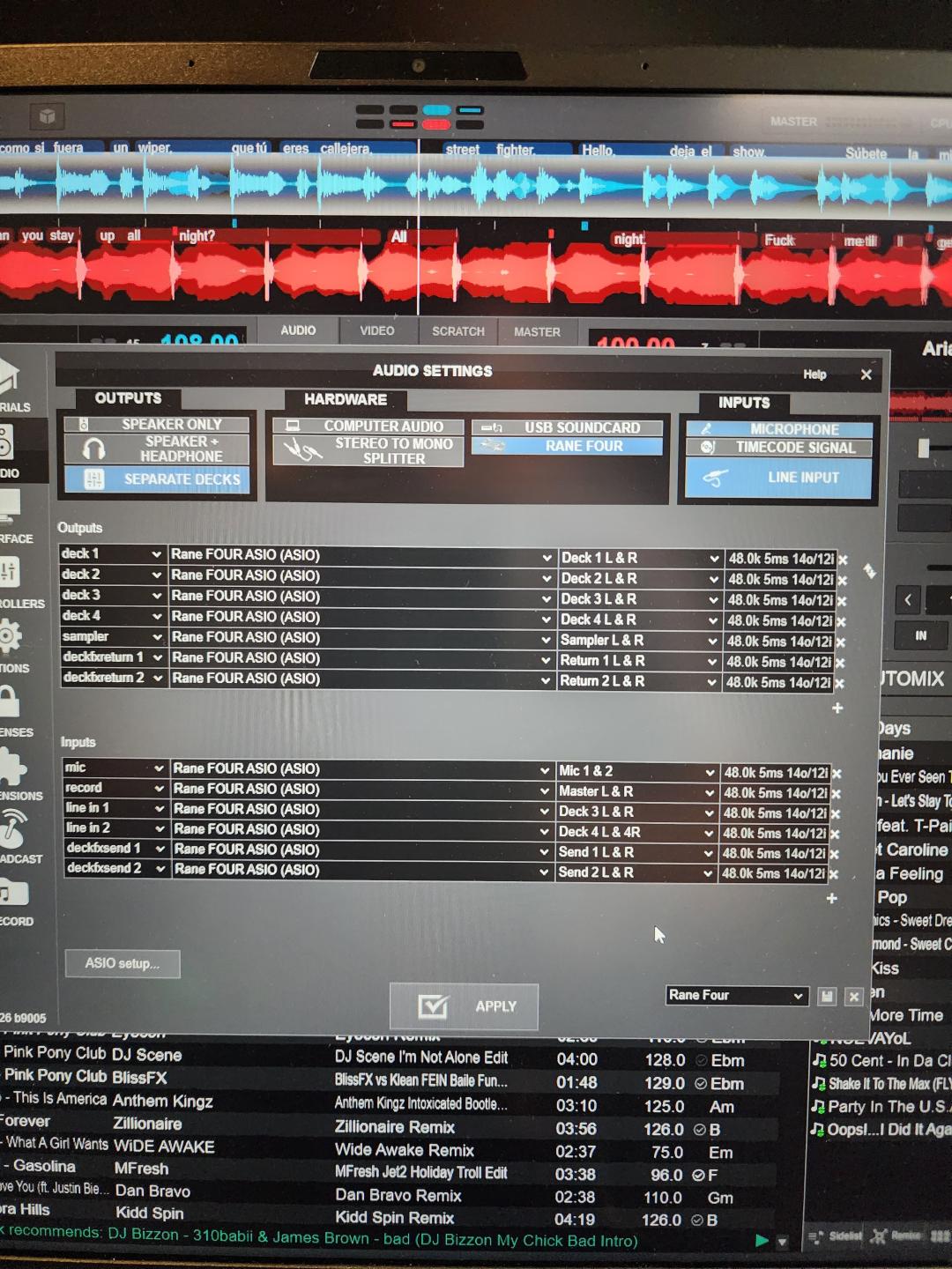

When I switch to software effects and use the paddle to activate, it mutes the audio. does this on all 4 decks. The meter still shows on the channel but no audio. If I activate the same effect on the screen in vdj by clicking on it, the audio works. The hardware effects work fine. Any thoughts?
Posted Tue 25 Jun 24 @ 10:58 pm
The paddle is applying the effect, it is just muting the audio too. This was working before and I cant recall changing anything
Posted Tue 25 Jun 24 @ 11:22 pm
Reset all options and it started working but it reset EVERYTHING. progress :)

Most likely the audio setup was incorrect.

Yea after reset I noticed it added to more entries in the AUDIO section for "fxreturn"...not sure how I changed that to beging with but got it rockin again

try set fxproccessing Pre-fader

I just bought the rane four and I am having the same issue. I can hear the effect being applied in the headphones.Just not out the mains.

Perhaps you disabled post fader effects ?
Please set fxprocessing option to post-fader
