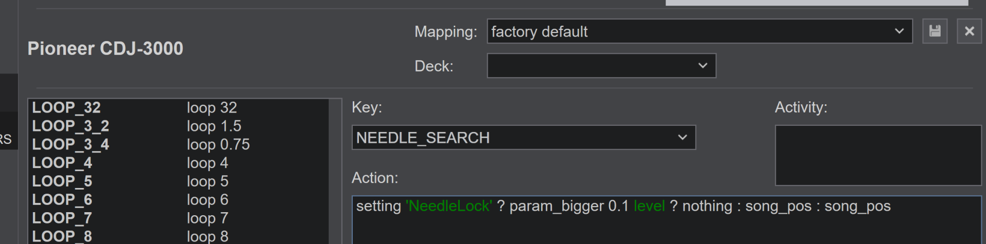

Do not have the CDJ-3000..... peaking at the manual.. it appears that one can search with the "Progress Wave".

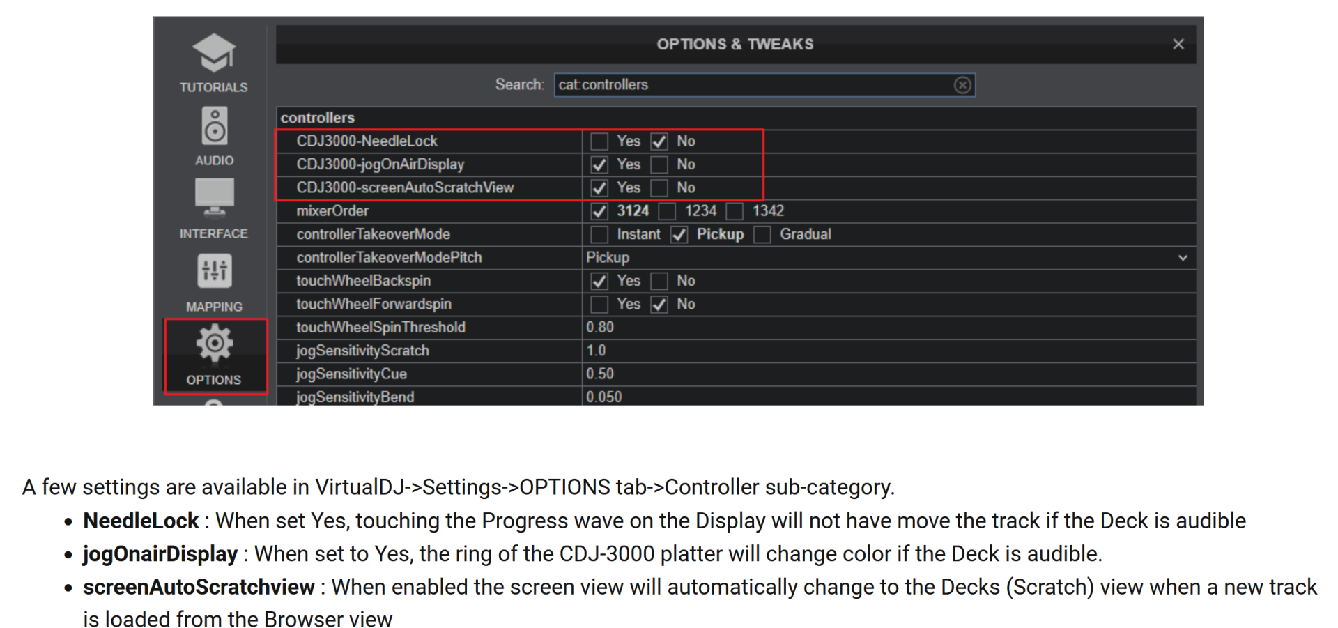

and is possibly dependent on the position of the decks level fader. (as determined by the option below)
And confirmed by the mapping for NEEDLE_SEARCH for the CDJ-3000
That if the deck's level fader is greater then 0.1 (not zero) then nothing happens .. unless one changes the value for NeedleLock in options, so it will work for any position of the level fader.
Check that you indeed have the deck's volume fader at zero..
OR you have the settings > Options > CDJ3000-NeedleLock set to NO
Hope that helps

curious question: why is the query... is_audible ? not used in the mapping?
I am sure there is a great reason.

Oh my goodness. You totally solved that for me. That's been bugging me for ages. Thanks so much for taking the time to write!

Is audible would "lock" the touch only when the deck is on air. However this also requires that VirtualDJ KNOWS if a deck is audible or not.
If you're using CDJs with a DIGITAL (MIDI) mixer and VirtualDJ sees (and knows) volume faders and crossfader movements and positions, then it would work ok.
However if you use CDJs with an analog mixer (that doesn't send MIDI) or you use a digital mixer but you don't bother to connect or setup correctly the MIDI part with VirtualDj, then the software WILL NOT know when a deck is audible or not.
PS:
On controllers, usually the "lock" setting works like this:
LOCK OFF:
Touchstrip always works.
LOCK ON:
If deck is not audible, touchstip works
If deck is audible, touchstrip doesn't work
If deck is audible, pressing SHIFT and using the touchstrip WORKS (shift unlocks the touchstrip)
Posted Thu 20 Jun 24 @ 9:03 am
