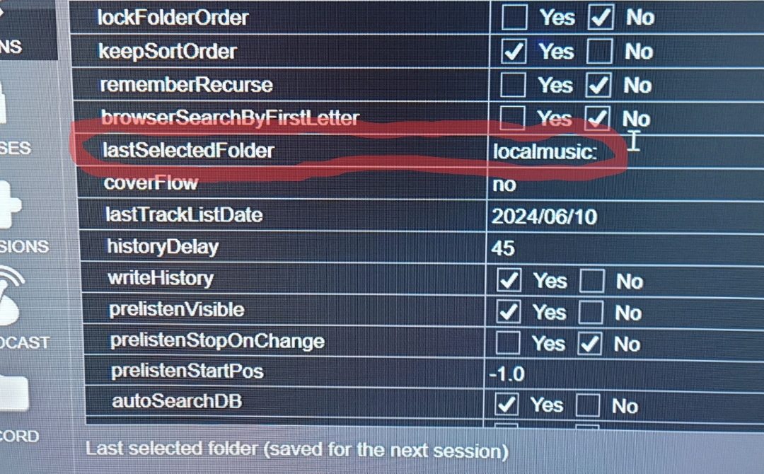

What is the formula to put in this box to get VDJ to remember the last folder I was on when I close the software? It starts empty since the last update.

the settings > option: lastSelectedFolder is updated when closing VDJ, to save, for the next session.
this is done automatically, assuming VDJ has write access to the location of the settings.xml file, and does an orderly close.
(are other settings changes not saving between different sessions of VDJ?)
Works perfectly here, with all current versions.
Which build are you using?
And the format for what is in the lastSelectedFolder field is just the path of the folder.
The path of any folder/list can be found from R-click menu > Properties of the folder.

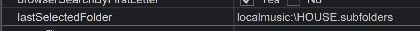

If when you last closed VDJ the "Local Music" was selected.. as in:
then the that will be the saved... lastSelectedFoder:
if say a folder named "HOUSE" was selected when VDJ is closed.. when reopened.. the option will appear as:
(if the Folder, HOUSE, was in "Local Music")

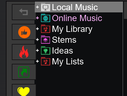

The problem I'm Having is no matter what folder I close out with, It goes back to "Local Music" when I open again. btw my tree is expanded even if I collapse all the folders. I can live with that.
