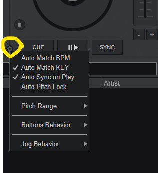

This seems like it should be simple.
I've read the manual and searched for an answer, but nothing has solved it.
Here's whats happening, I have Track A playing on Deck 1.
Midway through the song, I load Track A to Deck 2 as well.
I move the tempo slider on Deck 2 and the tempo of Deck 1 changes at the same time as Deck 2.
I have AutoBPMMatch set to NO in the options.
Anybody know how to solve this?

Note: I want to be able to "untether" the tempo of the two decks so I can beatmatch Deck 2 to Deck 1 because it is a song that has variable tempos.

click the small cog next to the cue bottom on deck, and turn off auto pitch.
(same place you can turn off other auto/smart features too)

Exactly what I was looking for. Thanks so much.

check settings for autopitchlock too
