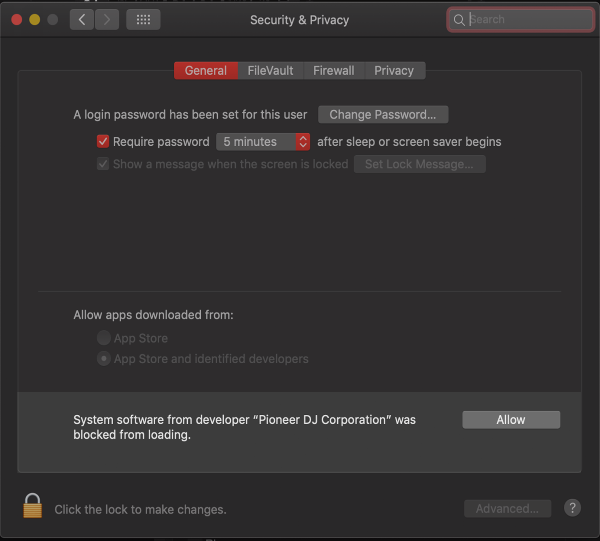

check if macOS have blocked the pioneer audio driver, very common it does.
https://www.pioneerdj.com/-/media/pioneerdj/downloads/other/troubleshooting/troubleshooting_highsierra_or_later_e.pdf
unblock the driver, and all should be good ;-)
