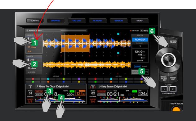

I think I now understand what was happening
I must have in some way changed to DECK 3 by mistake.....
It's almost impossible to know this has been done, luckily I recorded a video on the RX3 screen where I can see 'Deck3"

https://www.virtualdj.com/manuals/hardware/pioneer/xdjrx3.html
This is how XDJ-RX3 is supposed to work with VirtualDJ.
