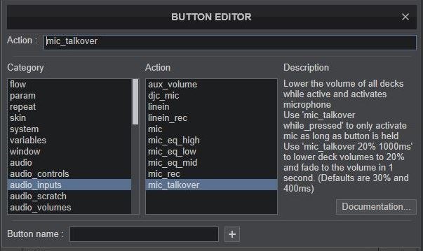

I create a custom botton using these settings:
Would this only work if I hold the button down?
I need to take the music up and down though
Can anyone help further with this?

For talkover I use a custom button with "mic_talkover 20%" for switch on and off. For a short upfade during my speech I abused my keyboard num.enter key with the config "mic_talkover 20% while_pressed", this key is nice and large and easily accessible.
Maybe this can help you a little.
