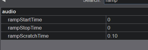

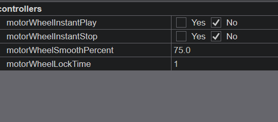

Still could not find solution. Still have kind of micro "ramp up" when stopping. here are my setting for motor and ramp time. Tried in Serato - sounds smooth.

If you don't want any ramp then motorWheelInstantStop should be set to Yes

In addition to what Adion has said(which should be the solution to your specific problem), I can see from your pictures that you did not set rampScratchTime to zero as I previous suggested. Please do that as well (it's something I found that benefitted my scratching on both controllers and DVS usage, making it more comparable to alternatives).

Yes, it helps a little bit. Audio slowing down sounds a little bit smoother but it doesn't solve my problem - "small jump/ ramp up" on stop.
I have a feeling that it is somehow related to "rampStopTime". When it is higher than 0 there is obvious jump, like pushing record with fingers. Tthat small jump remains when value is 0. Setting it to negative values apparenty doesn't make a diffrenece, it equals to 0.

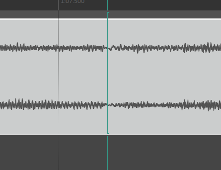

Here is image what waveform looks like when STOP is pressed on RANE ONE. Looks like sound is at that moment cut off anfd then jumps back in ..

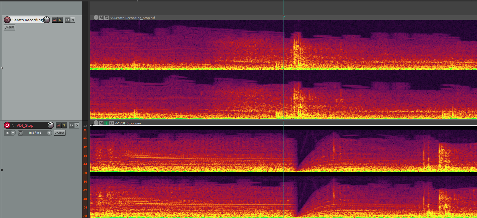

Till now I havent find any solution to problem. any input from developer team would be welcome.
I attach image of recordings in spectrogram view.
One can clearly see that pressing STOP on VDJ stops audio at first moment fully, then jumps back in and slows down (but not very smoothly)
Upper track is Serato, lower VDJ
