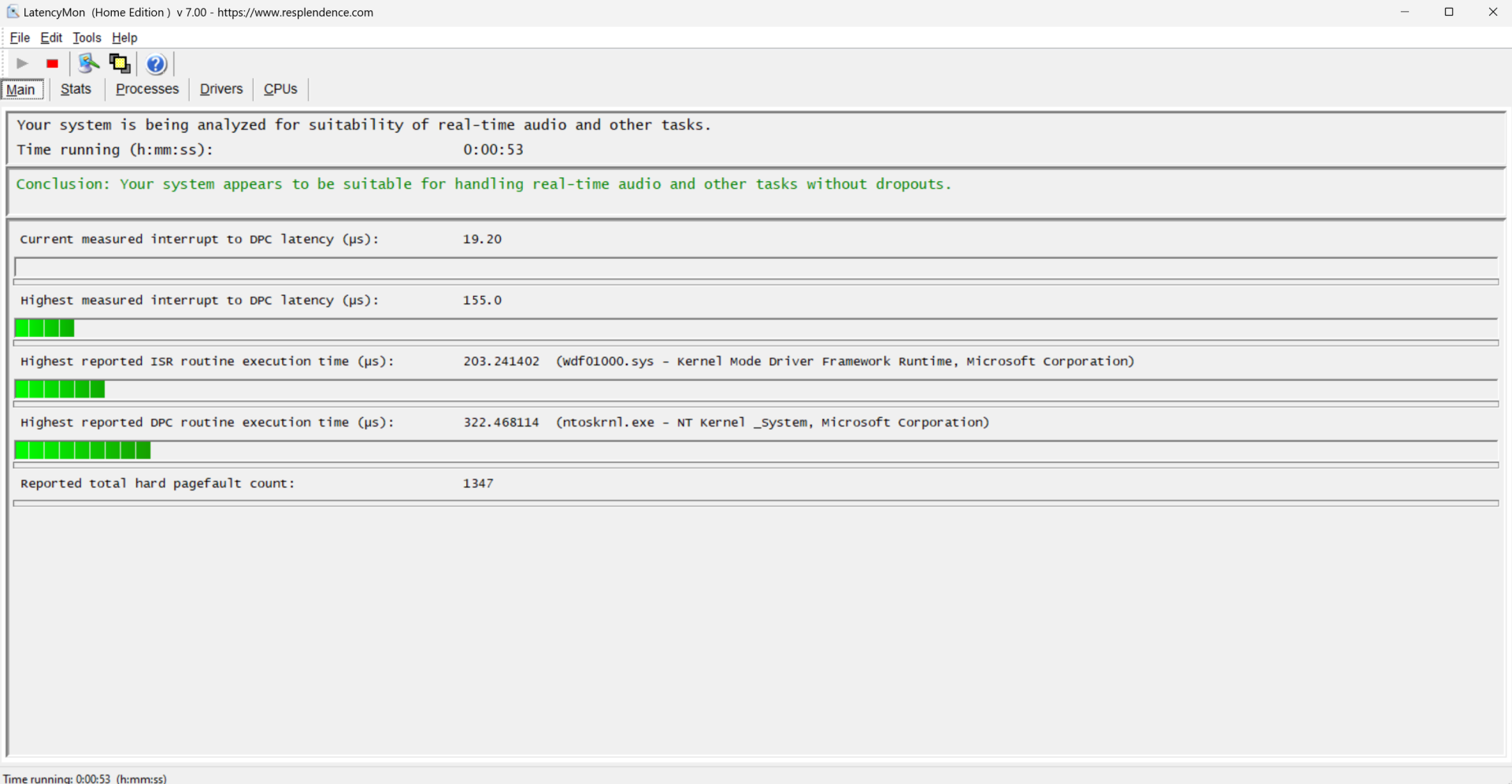

It can be a nightmare to track down. I returned three gaming machines because no matter what I tried the latency was far too high.
Ended up with an Asus Zenbook Pro X16 i9 RTX4080 and it's fine, but I had to do a bit of cleaning up and messing with power management settings to get it there.
For gigs I just stick with my ancient Lenovo Yoga C940 and just precompile stems on the Asus.
Here's what I get now which is far better than it was out of the box.
