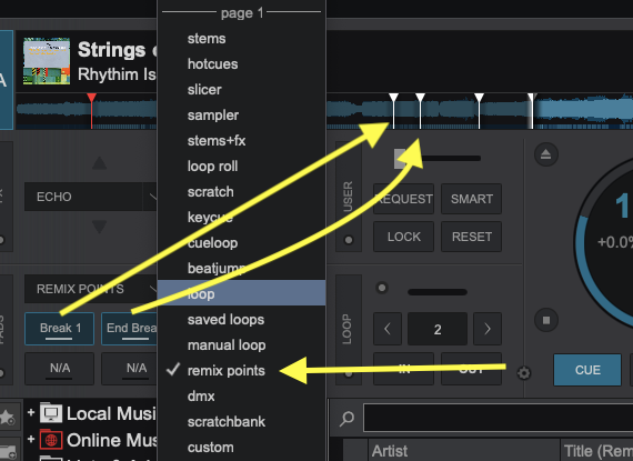

          It already does and has done for years. They are called remix points and are created when a file is analysed for BPM, etc. They are in the drop-down menu where your Hotcues are normally displayed (along with many other facilities you didn't know you needed 😊).

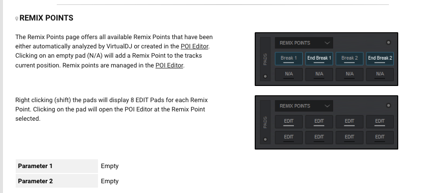

From the user manual 🧐
Oh my gosh! thank you. I have being using this software since 2019. I'm the dumbest DJ around for sure. Thanks!

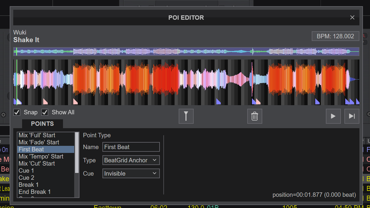

          Hi hi - thank you for this !!
my question .. would there be a way to have selected remixpoints made visible for multiple tracks? E.g. the "First Beat" and make it visible as red cue point on CUE6?
