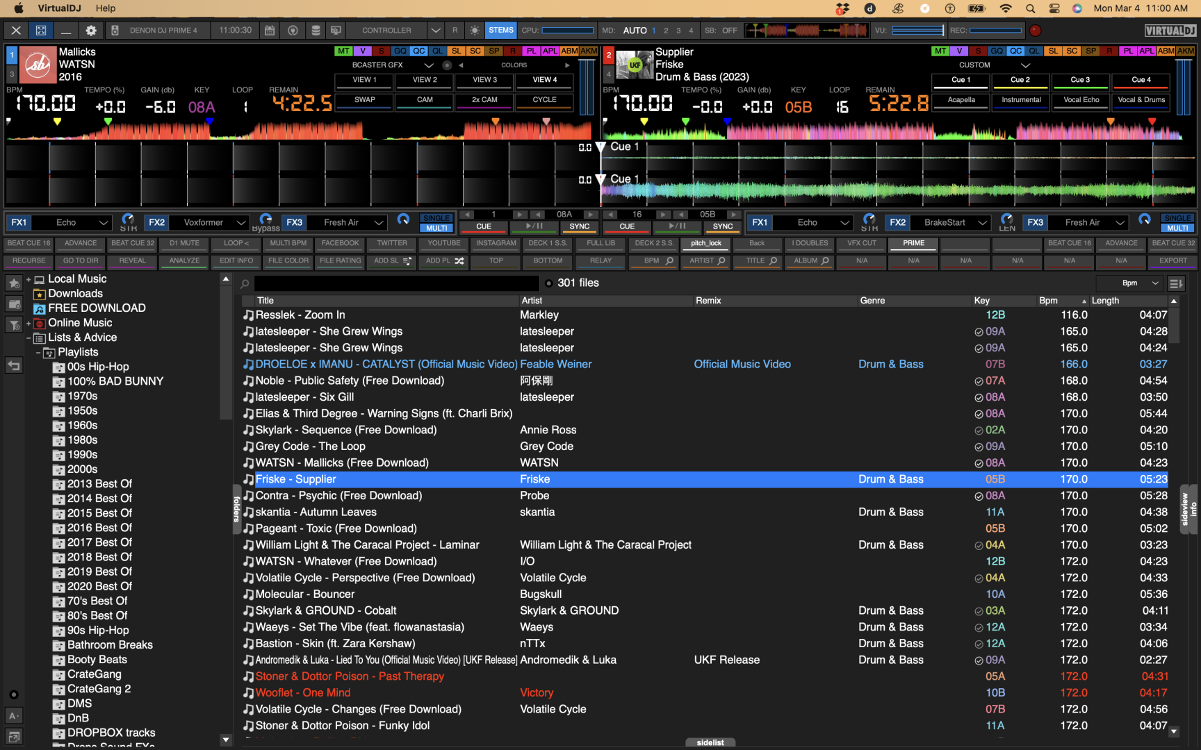

No problem but it was Bob who found it ;-p
Id Like a layout like this,
The waveforms on your skin are just way to big and take up way to much processing power on the unit. The screen shot is from Phantomdjs skin "Vector" and thats the layout Id love to have.
