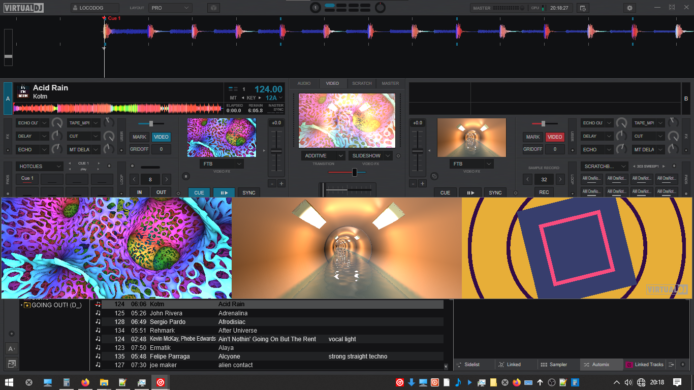

this is what I had on hand, north south is deck 3 , east west is deck 4, the bits in between are a mix of the left & right video deck 1,2.
I could design a vSkin to do what you want or a collection of popup windows if you can drag window to each device.

A video skin is what you want, it's the nature of a video skin, certain things shown in certain places.

I knocked this up, to specification I think, video skin 3072*768 decks 1-3 get 1/3rd of the width each, if the deck level is at zero for the deck then it shows deck 4
check PMs for dl link

wow! I'm gonna try that out. Thank you so much, Locodog!!!
