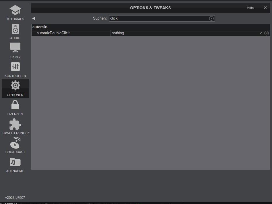

I've always found that when you double click on a track it'll automatically start playing that and mix immediately. maybe you can set up a custom button to play next track from the automix list.
Posted Sat 17 Feb 24 @ 3:30 pm
It's the same behaviour when I doubleclick a song from automix playlist: the old song is cut off due to load of the new song, before the crossfade finished.

automix ? automix_skip : mix_now 4000ms
