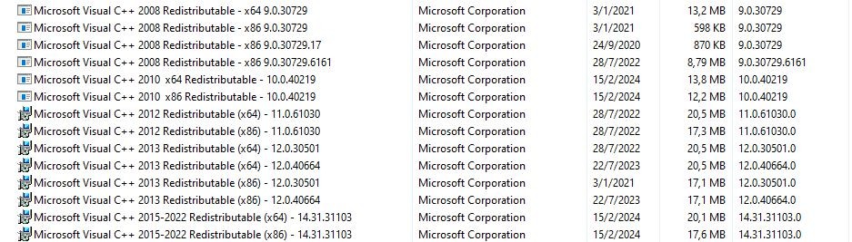

Hello again.
First I removed more than 10 updates of Microsoft Visual C.
Then, yes the drivers were installed successfully.
I started to play on my old laptop (windows 10) with Virtual DJ
and the controller, and it works perfect. It's been almost 12 hours without any mute at all!
Later, this day, I will try to do the same on my new laptop (windows 11)
to see if it works.
to see if it works.
