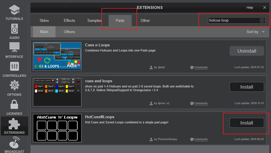

Install and use the Pad page named as "Hotcues n Loops"
